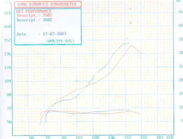

Folks,
Had my car Dyno'd today. The results of this are very interesting to those contemplating Exhaust Changes.
I have attached a Jpeg file of the dyno results. Some background. The car for this test is standard, was filled with BP 98 octane. The tests were done in 4th gear. First we dyno'd the car with the standard Nissan exhaust muffler (red line) and max power at rev limiter kicking in was 144kw. Because I have a removable pipe section between the resonator and the rear exhaust muffler we removed this and then put my extension pipe (about 500mm long) out of the rear of the resonator so the rear muffler is redundant, then ran dyno again. Max power at rev limiter kicking in was 148kw (blue line).
But wait look closely at the graphs. Each yellow grid is 3.2kw. With the muffler OUT, the car has less power [around 7kw until 115km/h but after that the the engine gives +11kw at 130km/h and +16kw at 150km/h where the engine would be revving in the high 5,000 rpm.
This confirms the butt dyno results.
So the conclusion I draw from this is that the muffler is very restrictive and if a straight through design is employed where the kilowatt drop will be almost nil then presto more power and you can use the muffler to give the final exhaust note to die for.
Discussions with the exhaust place where the dyno was done suggest that the Y pipe after the Cat Converters up to the resonator are likely to be restrictive also as the pipe diameter in the two flexible joints drops below 2" which is not ideal. So inserting more of a Y pipe [rather than the current U pipe shape] and having a larger single flexible joint in the straight pipe just before the resonator would provide better air flow and could give another 4kw if the improvements are similiar to the Hi Tech results reported elsewhere.

I attached the jpeg file but the attachment does not appear for you folks to see [or me on this forum]. It was 174Kb. Hm.
I used the Attached file bit above where you submit file, checked the right Jpeg but nothing appeared when I submitted it.
Where did I go wrong?

I believe there's a limit to file sizes you can attach but I'm not sure what it is. Try reducing the size and attaching again.
