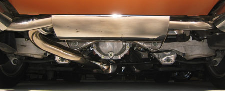

LeeBlue - Check out the driver's side hanger for the rear muffler - it comes within 3-5 mm from a metal panel which braces the\rear guard.
I've noticed that some installations allow the muffler to "wobble" when negotiating big humps, etc.

Default VERSION 3
NOW 'AINT THAT BETTER ?
But duck when you ask Ambrose to do it for you - "too hard"
I reckon that this is how it SHOULD be for $1760!!!!

That looks a lot improved on the ealier versions. The flange on the left is moved up (or is that just the angle of the photo), it all looks neatly tucked away. Is this sort of installation achievable with the standard kit and without too much work Frosty or did you have to get extra mods done beyond the norm?

Apart from shifting the fugly flange which is so visible because
of the much smaller dimensions of the original rear muffler, there's
only minor "fine tune" dimensional adjustments for a better
hang/fit. Plus the proper polish.

Thing is guys the HiTech system was designed as a direct Nissan replacement allowing you to purchace just the muffler or both muffler and Y-pipe, moving the flage makes it not as marketable for HiTech plus they've would have to rejig there tooling. My system was fully polished but after a few weeks it dulls anyway and as for the overseas product I believe the Aussie to be as good if not better in performance IMO and generally the flange is not that visable unless you crouch down, don't forget you have 30 days money back warranty, which you won't get with the overseas product.

Yep fitted myself, you just need to take your time, hang the new system up in place with all the nuts and bolts lose and make sure the hanger rods are bent into place to get good alignment, then tighten up all the flange bolts and nuts. There should be no rattles at any rpm unless some think is touching any body parts (this can happen on the rear muffler on the drivers side on the Track models with thier Aero defector panels).
