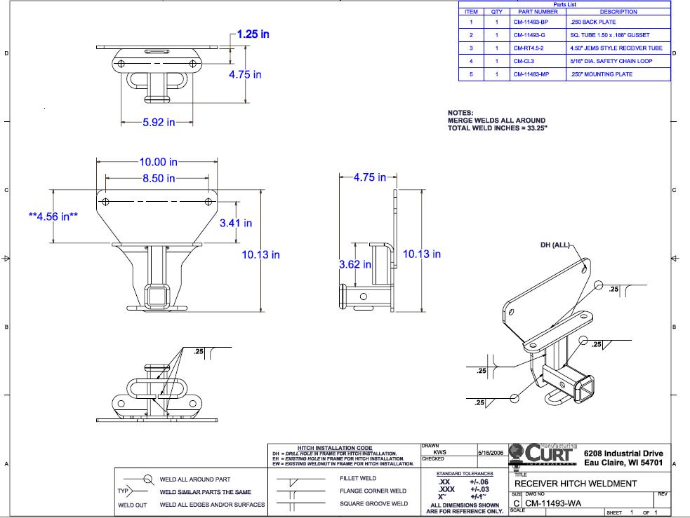

Default Check This Out!!!!
P/N 11493:
Click out the files!
- J
READ THREAD - SAME AS POST 14:
https://my350z.com/forum/showthread.php?t=347359

  #73
urban350z's Avatar
urban350z
Posts: 176
From: Snellville, GA.
Yup.. thats the one for 06+
Old Apr 16, 2008 | 09:27 AM
  #74
JasonZ-YA's Avatar
JasonZ-YA
iTrader: (60)
Posts: 11,204
Likes: 32
its also the one for my 04 -- actually 04.5 touring...
- J
