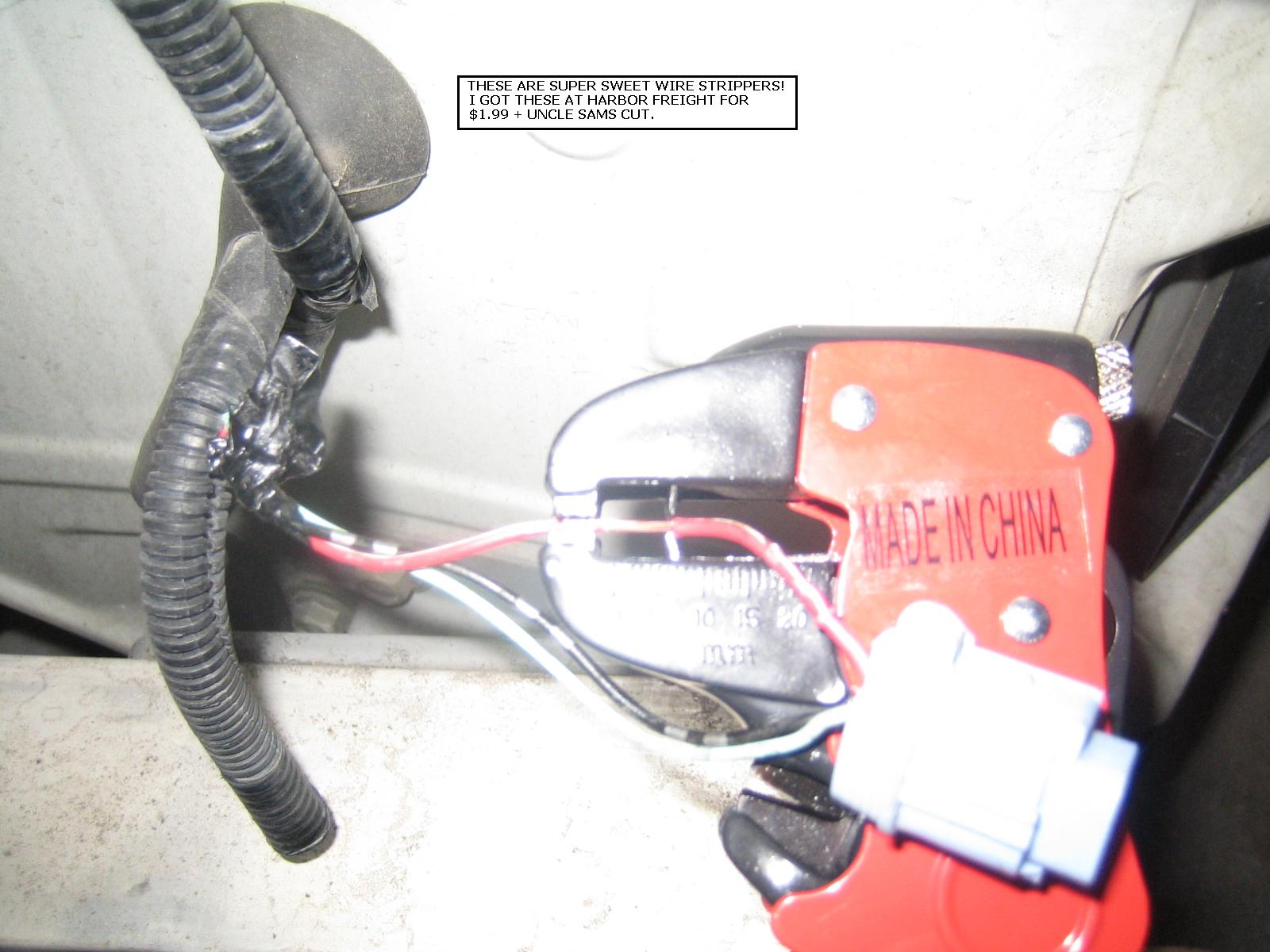

Default Wiring Install

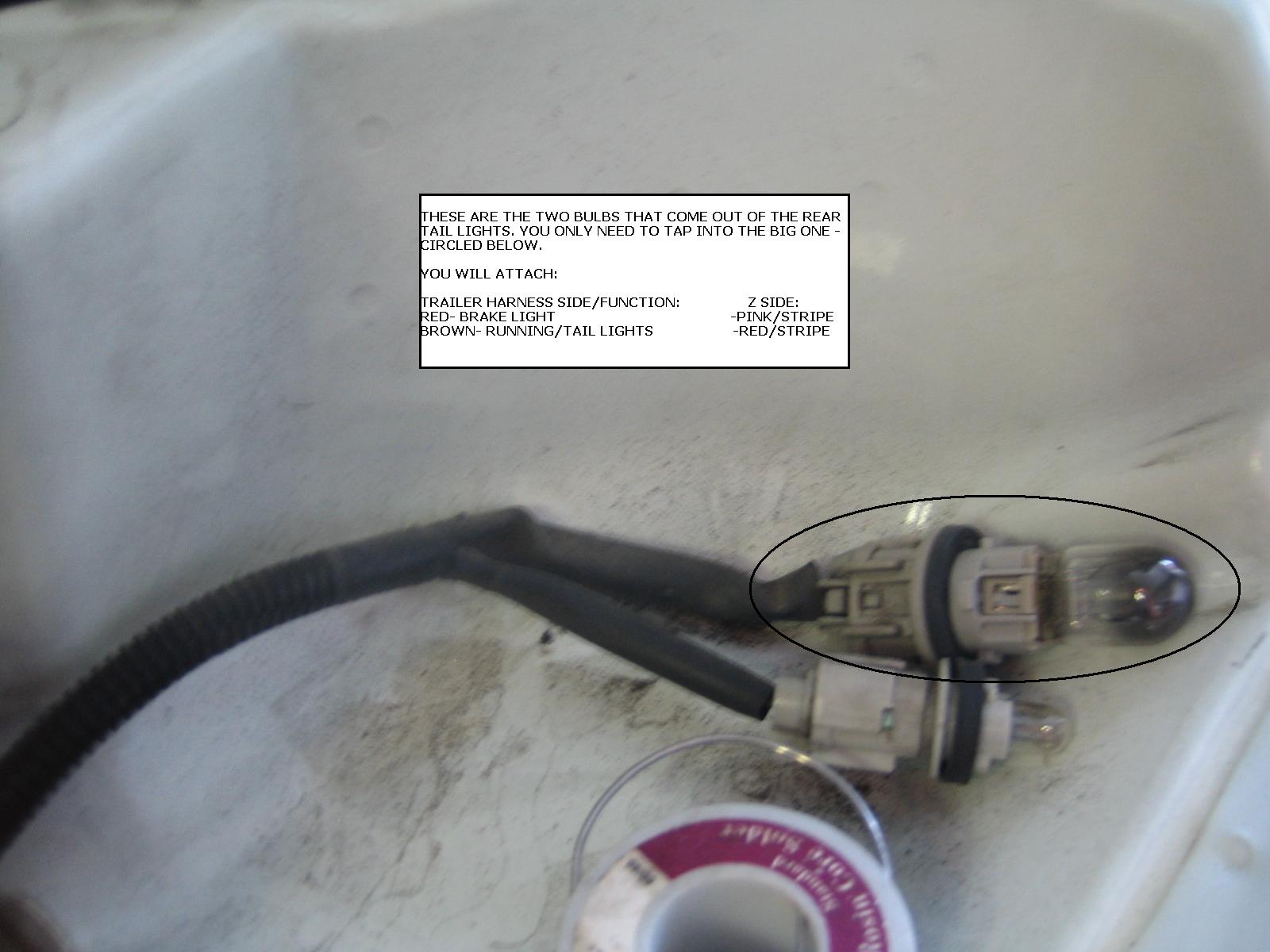

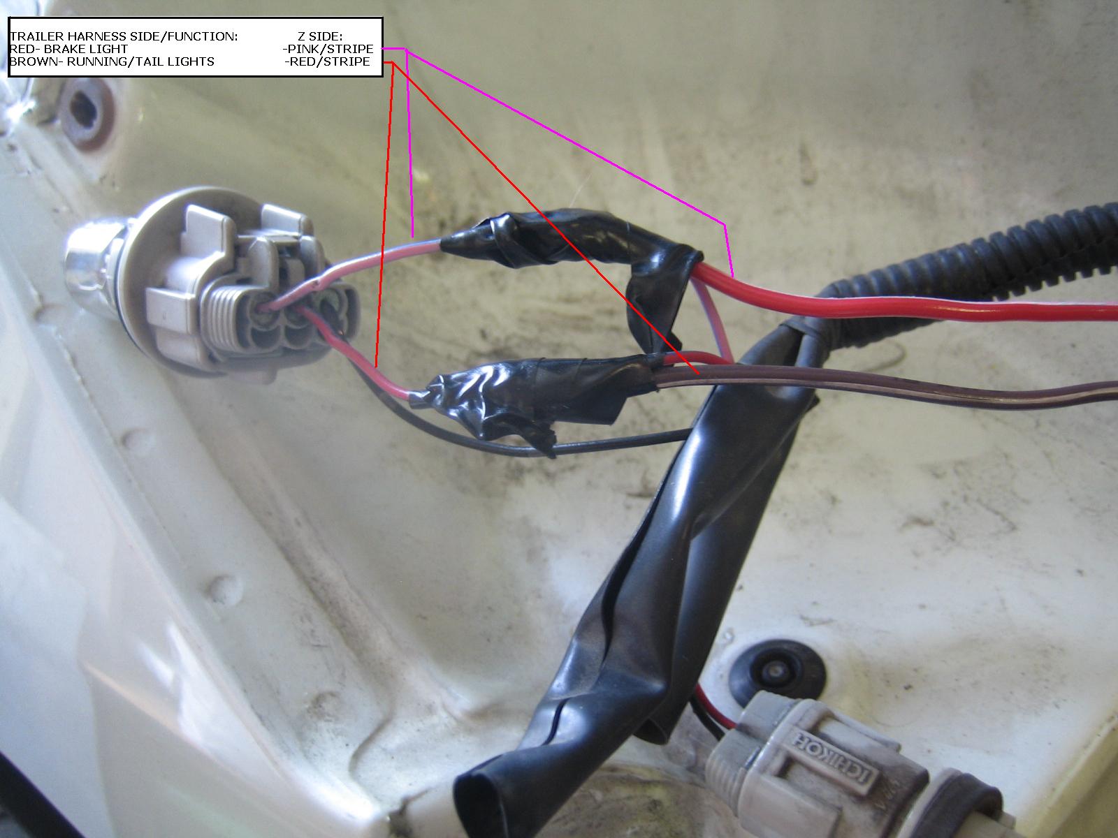

UPDATE:
TRAILER WIRING HARNESS:
ANY HOPPY BRAND - (AUTOZONE, ETC) WILL WORK - SO LONG AS IT IS FOR A CAR THAT HAS A SEPARATE** BLINKER AND BRAKE LIGHT LIKE THE Z DOES. GET IT?? THE DIFFERENCE IN HOPPY BRANDS IS ONLY DUE TO THE CONFIGURATION OF THE END (END WHERE TRAILER WIRES CONNECT - I BOUGHT A SEPARATE END AND ATTACHED ONE WITH TESTING LEDS ON IT).
I used a wiring light tester and verified all my colored wires did the exact function i was looking for.
I labeled in the attached pics the wiring colors for my 04 Touring Z but i dont know if the colored wires are the same for all Z's so i recommend buying a simple wire tester and double checking.
I dont have any pictures but i hot soldered all my connections and then used the ghetto electrical tape.
ALSO: FORGOT to mention, for the (WHITE) ground wire i just sanded a small area on the back trunk "firewall" if you know what i mean, and then used a short, small self tapping sheet metal screw. I positioned it low so i could see it by crawling under the car just to double check it every once in a while. just my 2 cents.
- J

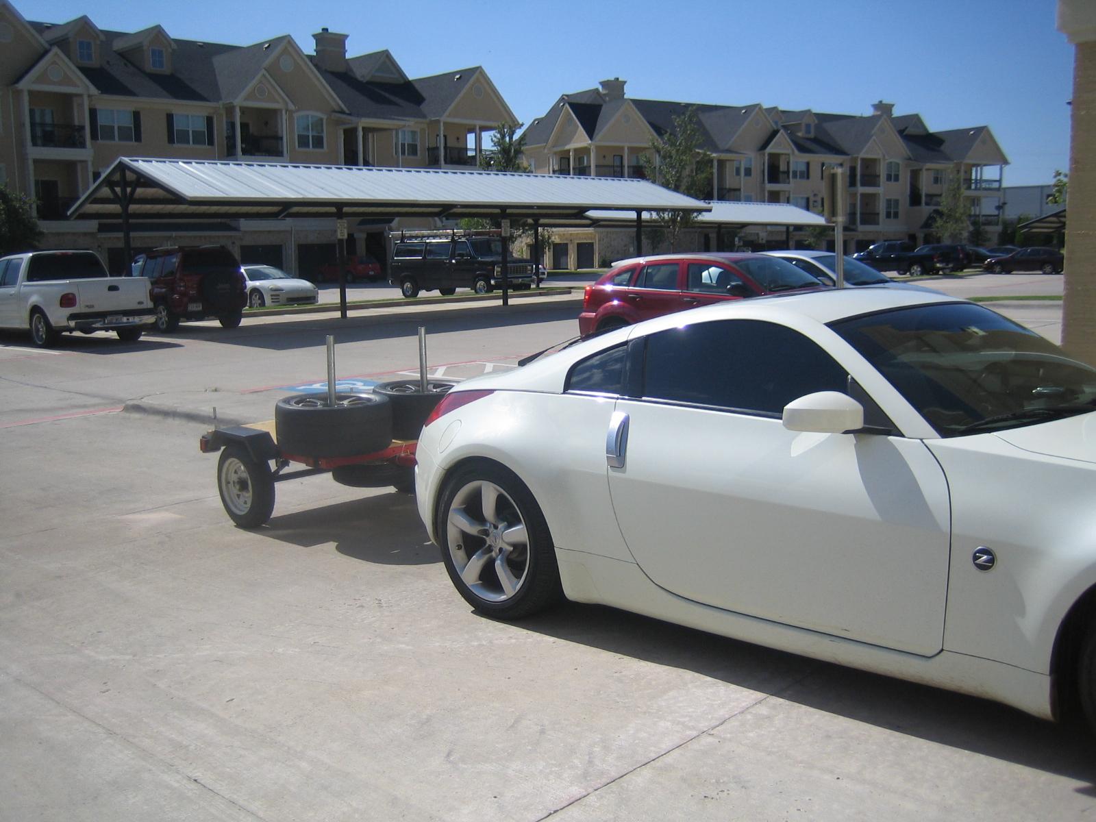

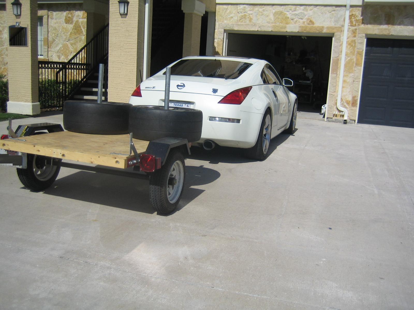

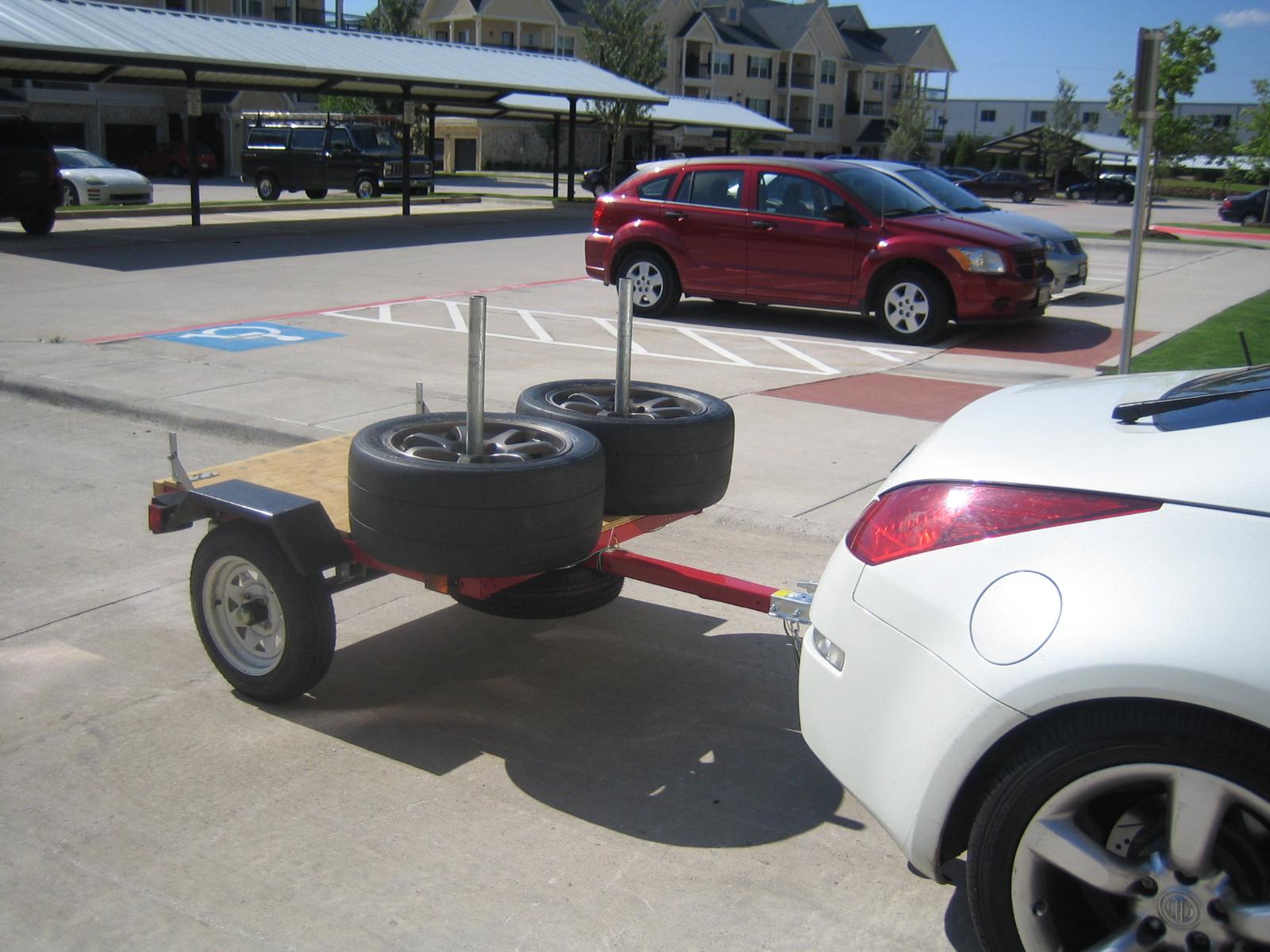

well, at least we know the HOPPY brand works, i tried it again and no issues so far. everything works great.
UPDATE OF PICS:
- J
