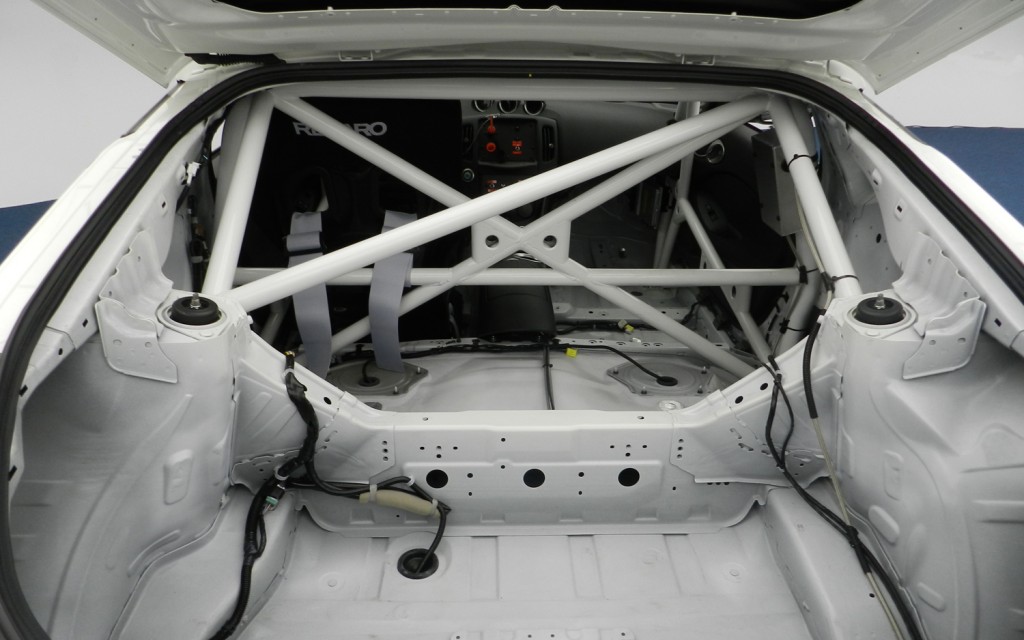

Why are you cutting the rear strut bar? I am just curious if the rear strut bar is really that heavy.
Yes, and going to get my stiffness back with cage
Here is the Nismo RC 370z
That's just the normal stripped interior for a 370z... No sheet metal removed.
Damn, thing is stripped and still looks sexy as H.
I know, just trying to give him an idea what I am going for.
