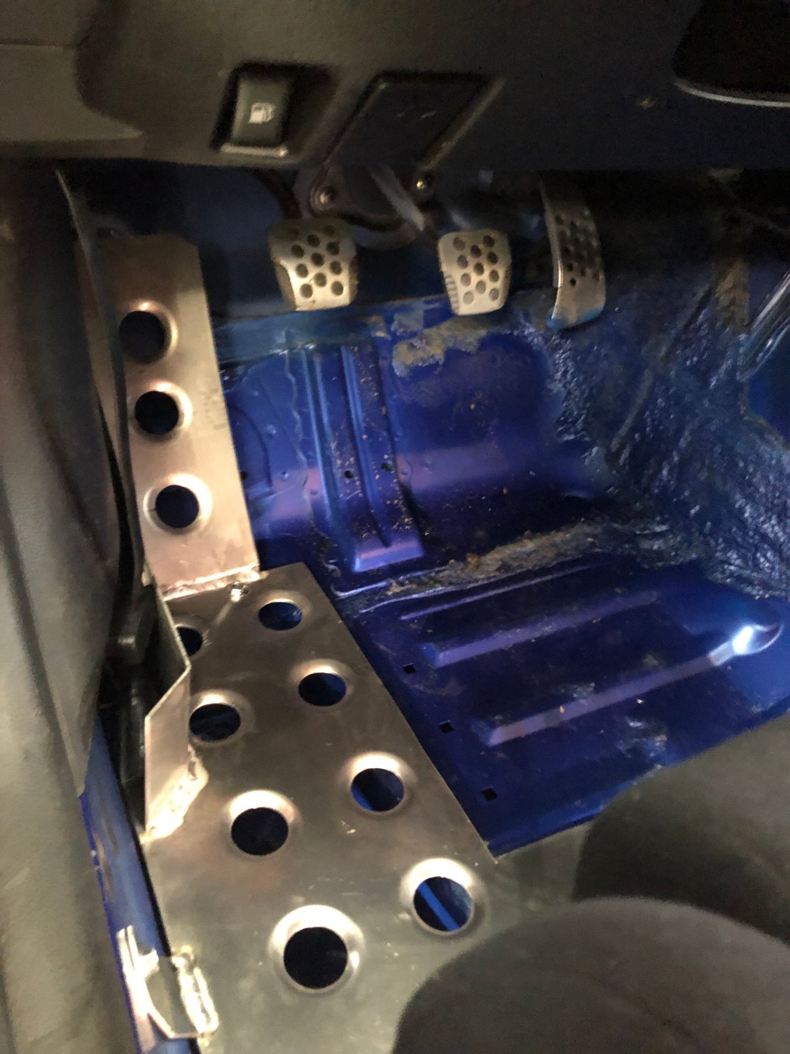

Ditched the carpet for good, made a heel plate for both sides to make the floor flat and dead pedal. Painted the floor blue
Got a new dimple die tool! Looks racecar
