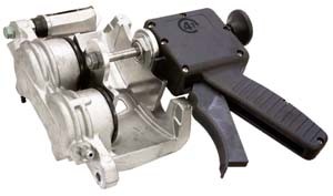

I recently bought a Private Brand Tools (PBT70915) 4 in 1 Brake Pad Spreader. I used it to change the pads and to flush my Stoptech brakes. I am very satisfied with this tool. It worked very well and the quality is top notch.
This tool works on both fixed and floating calipers. It has heavy duty steel plates to push all four pistons in simultaneously. The plates rotate 180 degrees so you can position the handle for maximum clearance.
This tool allows me to spread the brake pistons completely in seconds. I am able to use it to hold the pads in place while each caliper is removed from the mounting bracket for vertical bleeding. After bleeding, I can easily remount the caliper and the pads as a single unit onto the bracket. I don’t need to remove the mounting bracket and that makes bleeding much quicker.
This tool is much cheaper than the GiroDisc tool and it serves the same purpose. You can search the video on Youtube to see this tool in action. I think this is a must have for anyone who works on brakes.

Jason - as you can see, that device only works on single piston designs. A dual piston would not have the opening on the opposite side of the caliper to allow that particular tool to work the same.
The PBT spreader has two plates, each one goes on opposite sides of the rotor and pushes both pads outward simultaneously.

The advantage of the PBT brake spreader is that the two heavy duty steel plates can rotate 180 degrees so you can easily position the handle to fit in the fender well. This is important when replacing the pads on my Stoptech brakes because I have to take the calipers off of the mounting brackets to keep them vertical for bleeding, and at the same time use the tool to keep the pistons retracted and hold the pads in place as if the calipers are still mounted on the rotor. This tool gives me the ability to not remove the mounting brackets from the uprights and that makes the whole job much easier. The caliper mounting bracket bolts require 95 ft-lb of torque and my big Stahlwille torque wrench is just too long to do the job without the car being on a lift. The PBT tool is easily strong enough to hold the pads in the calipers firmly during bleeding, and I can reinstall the caliper, pads and my titanium backing plates as one single unit onto the rotor after I am done bleeding.
I don't have any experience with the other tools so I can't comment on them. I can no longer find the youtube link, I think it has been removed for some reason. i will post it if I find it again.
