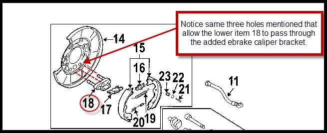

Like he is explaining all the mounting points for the drum styled parking brake pieces are on the brake dust shield. The brake dust shield itself is what mounts and aligns the components of the oem drum shoes in place for the oem style parking brake set up.
See this picture here:
- in that picture you see the 3 holes that are added to the bottom of skyfers bracket - the two outside holes are actually mounting bolts with a funky bracket that is required for the use of the oem parking brake.
-from there the hub bolts themselves goes through it as well.
-ALSO, items #21,22 and 23 in the pic are what hold the parking brake shoes to the dush shield.
-The middle hole is just a hole - parking brake cable runs through middle hole.

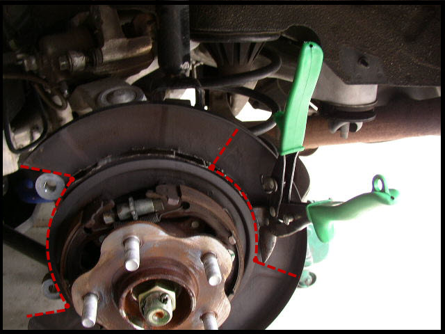

now, to accommodate the added 2nd caliper you do have to make a notch for it in the brake dust shield like shown in the following picture in red dashed lines like the oem caliper location.
Or you can snip off the entire circular brake dust shield (like the green snips are doing) leaving only the center section that retains all the parking brake mounting components.

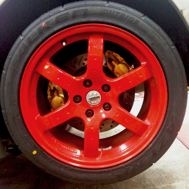

I also found some time to throw my Patinka kit on this weekend. Very happy with it, would have been nice if it came with hardware. But I actually found an awesome hardware shop just down the street, that set me up with everything I needed for around $20. It was nice to select my own grades of bolts. I ended up ditching the dust shield all together and good riddance to the oem braking brake.
I was using the K-Sport hand brake as an inline system before. On that set up I had to unplug ABS witch was interesting. Now that this is an independent system it feels much better that they aren't fighting each other and glad to have ABS back.

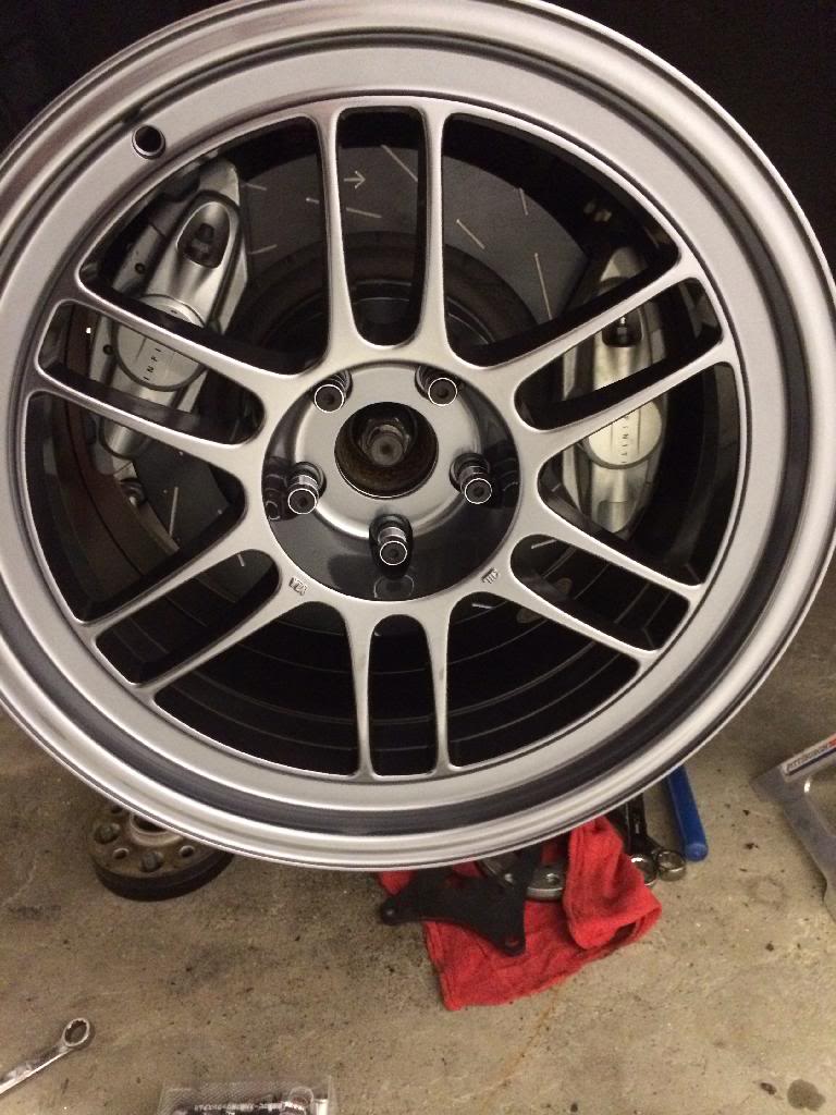

Attached Thumbnails Dual rear calipers ebrake-dualrearcalipers.jpg   Dual rear calipers ebrake-dualcaliperswithwheel.jpg

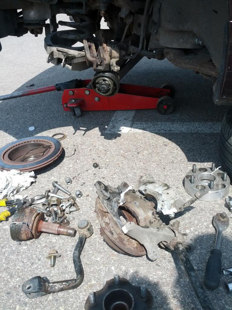

Last weekend had a chance to test the strength of my caliper bracket.
Broke the cv joint on the axle, bent the camber arm into a V shape, bent and twisted the traction rod and spring bucket, bent the upper control arm and broke the knuckle. As far as I can tell the bracket is not even bent.
