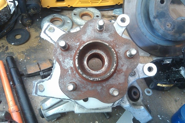

I made a template in a few hours time. It seems you may be over thinking it a bit.....I was lucky enough to come across a junk yard spare rear complete hub and spindle from a buddy of mine to do all my mock ups.......
Start off by:
1. when you get to removing the cotter pin from the axle, PRIOR to removing the big 36mm nut, notice that you only have about 1/4" to max 3/8" of room on the cotter pin hole....
2. Remove everything, axle and all and get down to the hub and spindle.......from the back side remove the e-brake cable and silly little mount that has two studs on it.
3. Now remove the actual hub from the back of the spindle - there are 4 bolts
4. From there I used plexi board - ie, home depot, walmart cutting board, anything will work, so long as it isn't brittle and see through or at least opaque will work/help in matching up holes. I used a shop florescent light behind it and traced the hole locations, hub hole diameter big hole and started cutting. with that, i was able to mount it all up.
5. position the caliper at about 9 o-clock position (passenger side rear) as the caliper body needs to be just right to not hit the spindle anywhere.
6.in my template you can see how i did a quick rough outline in black marker, but ended up cutting a bit off of that......i didn't care, just needed all the holes to match up. I have since cleaned it all up........machine shop will take care of the rest.
7. I'm making mine from 1/4" thick steel as doing this bracket now changes your rear wheel offset - plus you must pay attention to that cotter pin in the AXLE from step #1???? I dont care about the offset so much as i normally run 20mm spacers in the rear, so now ill just run 15mm spacers on my wheels and be just about the same.....
8. I'm an aerospace structural analysis engineer so by my calculations 6061 plate will work at 1/4" thick, but im just gonna have mine fabricated from 1/4" thick steel plate.
9. from there the e-brake mount plate is gonna be the bologna....LoL...
sandwiched between the hub and the spindle....source longer bolts to reinstall the spindle due to the mount plate thickness.........I believe they were M12x1.25x35mm long...but measure and check. grade 10.9 flanged hex head.
10. TAKE NOTE - that the oem caliper mounting points are .300 recessed from the spindle hub mount location........SOOOooo, some ingenuity needs to take place as simply mounting a caliper onto the bracket wont exactly work.....hence the 1/4" thick plate(.250) max...........being that its close to .300 offset of the oem mount calipers.........
11. you will now need spacers at the oem caliper mount locations and new bolts....ie brembos use different bolts than non brembo calipers..if brembo its M12x1.75x40 or 45mm length...but im sure its 1.75 thread pitch.
12. I plan on taking my template and spare spindle to the machine shop to ensure they get my "Traced" measurements just right.
My template:
90 percent complete:
Initial mock up and back drill of holes, rotor trace, etc:
You can see two of the 4 longer bolts i got in this pic on the right......with template in the mix...
-J
