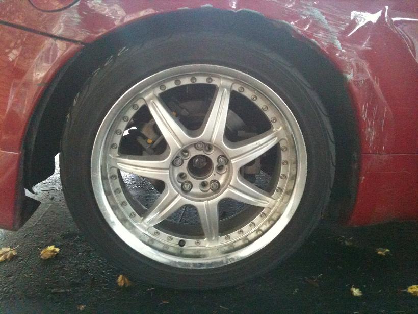

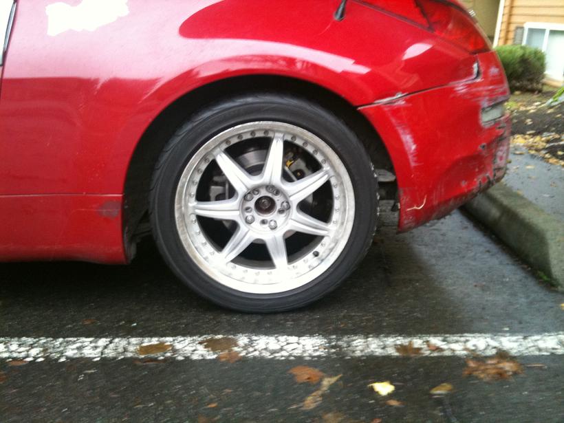

so far o good! No issues!

Awesome....good job..
so it appears you mounted an angle of aluminum off the tranny tunnel then mounted the wilwood set up?
-J

Yes it's just a simple L-angle out of 6061 T-6 drilled some holes on the side of the tunnel and bolted it into place. The handle is right next to the wheel but no to close where it gets in the way.

Well the new e-brake could have not worked better! After two days and 4 pairs of tires with wet and dry conditions No issues at all! It was so easy to locked them up, and after I got used to using a ebrake it was so much better than left foot braking and it made the drifts flow much smother when u had to slow down not all jerky and twitchy!
