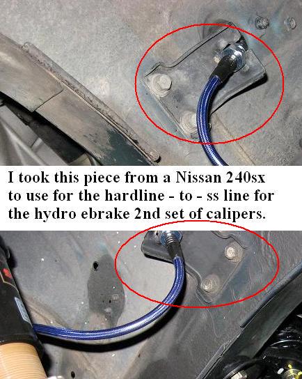

YES....most dont comprehend that this is a "separate" stand alone brake system being added to the car.
I plan to purchase Wilwood remote master cylinder kit - p/n 260-10372 $85.95:
http://www.wilwood.com/MasterCylinde...ter%20Cylinder
Then the CNC 402 hand brake:
http://www.polyperformance.com/shop/...ke-p-2176.html
So long as the Wilwood will mount to it, from the Wilwood diagram, the mount holes are 2.25 inches apart. I need to confirm the Wilwood will work with the CNC unit.
If not, i see that you (rubabealf) simply cut a Wilwood foot pedal and attached your own handle....
I'm choosing the Wilwood because the kit has the "screw on type" cap on the reservoir, so i can use my motive power bleeder to bleed the system easily. I want to run the hose out of the car and under the hood....I dont want to mess with brake fluid in the car.
From there ill probably have custom ss lines made or hardline the 1/8-27 NPT Wilwood outlet to a Tee fitting to then more hardline or custom line to each wheel well. Then to some extra 350z wheel well brake line mounts from the junk yard (taken off a 240sx) to where i can attach brembo rear SS Lines using the factory clip style to brembo calipers mounts.
Spare 240sx hardline mount:
I plan on using bailing wire to mock up my hardline routing...I can then take the section of bailing wire and bench side pipe bend the brake line and it should mount up perfect...
-J
