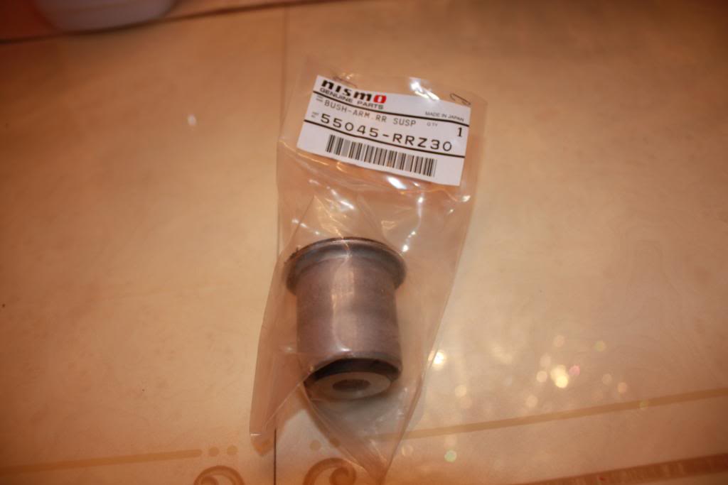

I'm in the process of installing the Nismo rear bushings in those arms. I already did one side but still need to do the other. I'll take a few measurements and pics when I get home today.
I'm getting busy with installing a bunch of rear bushings. So far the list of things being installed/in progress:
Nismo rear upper A-arm bushings (2/side)
Nismo camber arm bushing at knuckle (1/side)
I also already have battleversion camber arms which are solid at the subframe
Nismo radius rod bushing at knuckle (1/side)
Nismo spring bucket bushing at the subframe (1/side)
Nismo shock absorber bushing (1/side) (These sit at the top of the shock and not at the knuckle which I didn't realize, but whateves installed anyway)
SPL shock absorber spherical bushing at the knuckle
SPL spring bucket sperical bushing at the knuckle
Nismo doesn't provide these two to my surprise so I ordered them from Kuah today. They are the exact same size bushing and should get here by the end of the week...I'll take pics prior to install.
All in all I'll have just about every rear bushing replaced with a mix of Nismo and SPL

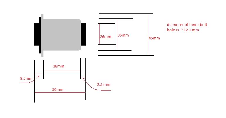

Here is a pic of one of the Rear Nismo A arm bushing and detailed measurements of it. 4 of these are used and they are all identical.
