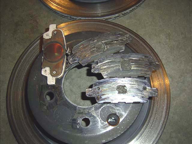

Old Dec 4, 2003 | 06:43 PM
Redfoot's Avatar
Redfoot
Posts: 395
From: Michigan
Default You mean they looked like this??
2 days at Michigan International with VDC left on in error.

Default Re: You mean they looked like this??
Hey, mine have looked like THAT twice now!!!
VDC always off...
