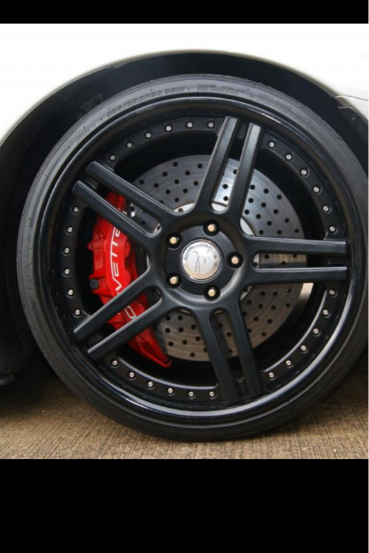

$3k for these bad boys. I'm reallllllly tempted. They are $7k brakes. I believe 16" rotors. Jezzzz
