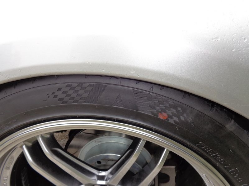

Thanks again for the information. I am hoping to get the Bilstein B-8 with either the Eibach Pro or the Tein S-Tech springs. I will keep you posted with my project. Currently I have the Volks TE-37 on 19 with a +22 offset. My tires are the Michellin 285 rear and 255 front.
Careful once lowered, might need to roll the guards.
Good point Mic. My rear wheel offset is 15 mm, but the tire size is 275 mm. I only rub in the most extreme suspension travel. 285 mm tires might rub, but photo2u is running a 22 mm wheel offset. If he goes with less than a 1 inch drop (something like a 0.6 inch drop), he might have minimal or even no rubbing. Not sure...
Yeah, I honestly don't know if +22 offsets will rub or not. Mine didn't but that was AFTER the guards were rolled (done only because my 9.5 +15s rubbed on a good bump) and it's pretty snug for pushing it hard. 285s on these.
I truly do not want to roll the car. I was thinking of JHC's set up of Bilstein B8s paired with Eibach Pro springs? But after checking the 1" drop It would not work.
Does anyone have the OEM spring with Bilstein? Or any other set up? How are the OEM springs with aftermarket shocks? Has anyone have recommendations for my +22 10.5 rims with 285 Michellin pilot super sports rear and 255 front same rim offset and tires.

Friends,
I will be rolling my rear fenders to avoid any future trouble. I was wondering if I need my front rolled aswell. After searching in Offerup, I was able to find someone who looks professional. Do you know someone reliable in the Claremont California area? I am doing the Bilstein B-8 shocks with the Tein S-Tech springs. I found some parts on line. However, if you have a new or mint set, please let me know.
