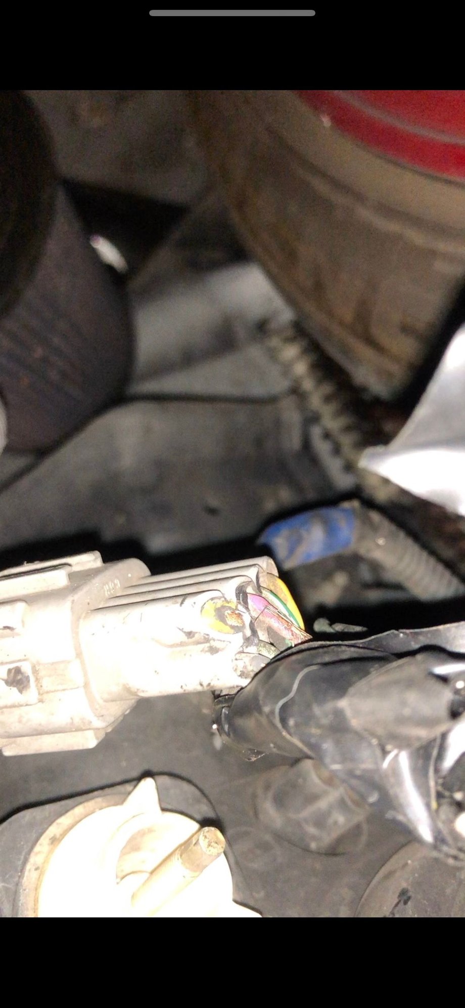

Was looking for a short and could not find one anywhere. But i did find this, a plug going into my headlights and it looks like my tire has chewed off one of the wires.... zip tied it up and out of the way. Could this be why my rear running lights and brake lights are not working??? Btw what is this called?
Also turned on my hazards and nothing so it is not the brake pedal nor any aftermarket wires. I do tho have blinking brake lights but they are only a couple months new.
Well that's progress! Finding a damaged wiring harness/junction could easily be your solution. The easiest way to get around this is to buy enough "butt connectors" of correct size. They look like a little tube, get the ones with vinyl insulation. Cut 1 wire at a time on either side of plastic box, same color. Trim 1/4" of insulation off both ends, insert into connector and crimp that end hard with crimper or pliers. Repeat until done. Should cost less than $5.
If the wires are different colors on either side of the big connector, go by their position on the connector to rejoin. Gl!

so OP... are you saying you dont have fender liners?
probably the case. I drove without liners before and just recently realized the same junction on my headlights was rubbed out like stripper night with no lube. Still works though!
