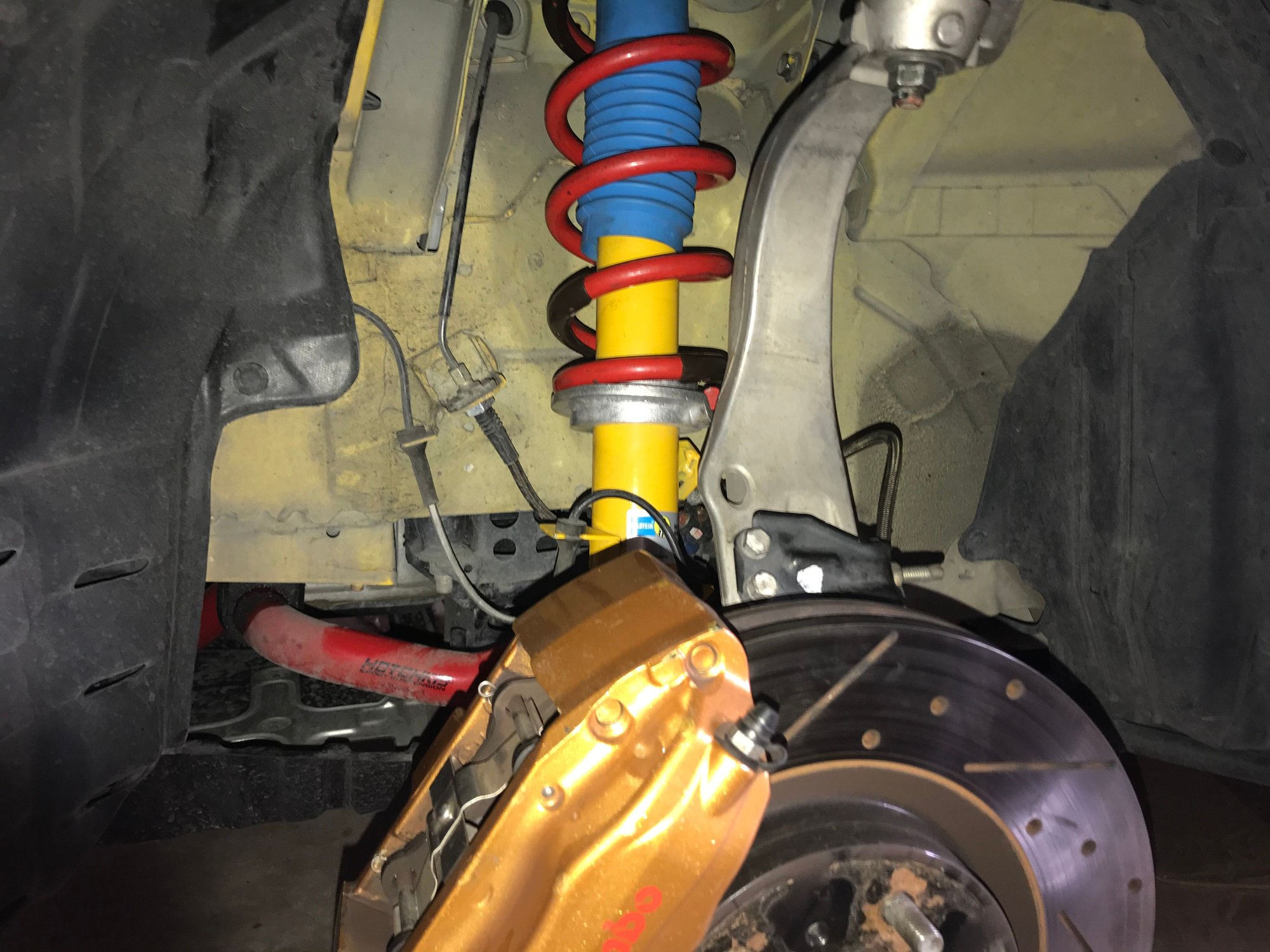

For what it is worth, I went with the Bilstien shocks and found some good used Nismo OEM springs also added Brembo Brakes. 2005 enthusiast model. I think I am the only person, besides you, that wants to maintain the oem ride height. Never have to pucker up going over speed bumps etc.

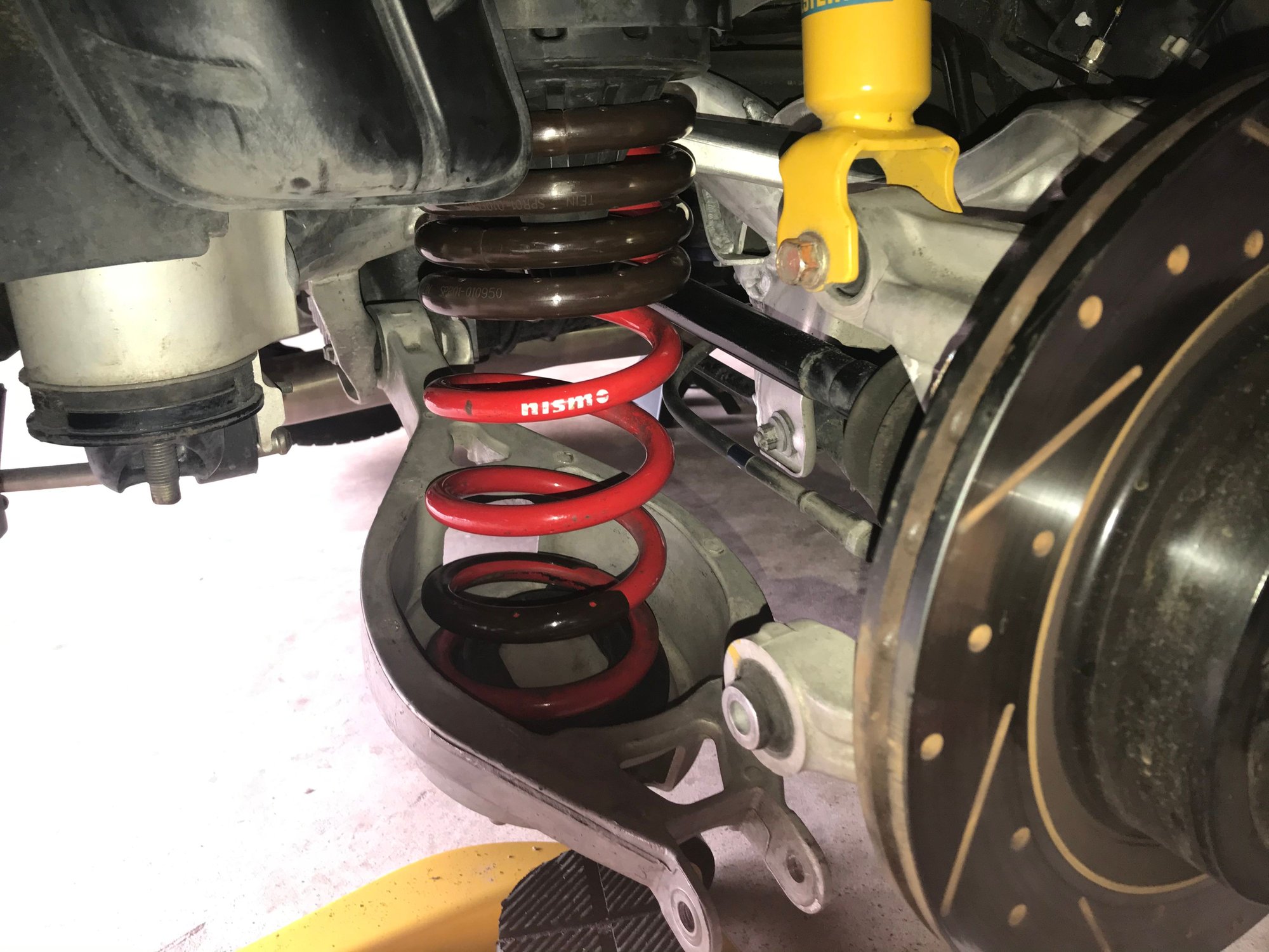

I used Bilstein B6 shocks with Factory Nismo springs. I also added a Hotchkiss front adjustable sway bar (using stock end-links)
I picked my springs up off Ebay from a California based company for $155 bucks plus shipping.
I sprayed degreaser and washed them off. Looked really good.
I cannot get phone signal to check the name of the vendor.
Having autocrossed with stock springs and stock shocks, the difference is EXTREMELY noticeable. On the street, not so much. I rarely drive more than 3 to 4/10ths on the street.
