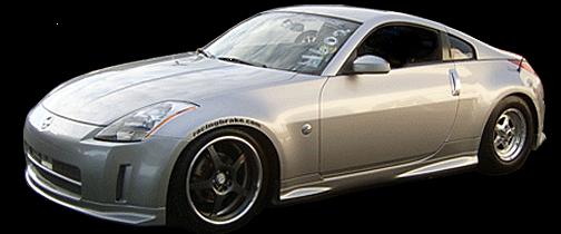

I have pulled 1.8 with my drag Radials and 1.7 with my M/T streets... No offense but you have to learn how to launch with your clutch setup. The Tilton is not the best choice for the drag strip... You can run a 15x 9 or 10 with no problems and a 26x9 ro 10 slick with no problems but you are at risk to break your axles... I broke my cv joint once so far and that was launching at about 5200 rpms on 9.5" wide M/T street ET's .....

Sorry I cant give you advice on the Tilton cuz i dont have one, but nice trap speed. What other mods do you have?
