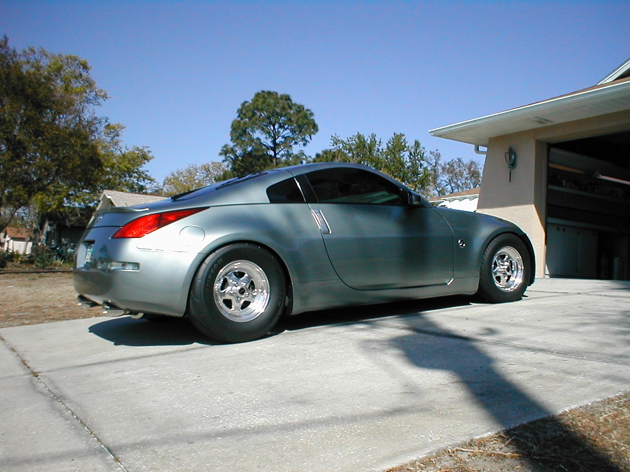

WHEELS AND TIRES
Pro Star 96-Series Wheel REAR
Size: 15'' x 8''
Bolt Circle: 5 x 4-1/2''
Rear Spacing: 5-1/2''
Pro Star 96-Series Wheel FRONT
Size; 15'' x 4''
Rear Spacing: 1.875"
Mickey Thompson ET Street Radial Tire REAR
P275/60R15 (28'' x 11.5'' - 15'')
R2 Compound
Special Sidewall Construction for Quicker Launches
OR
P275/50R15 (26'' x 11.5'' - 15'')
R2 Compound
Sportsman S/R Radial FRONT
26'' x 6''R - 15''LT

Crap, I just saw you have Brembo's, sorry.....
