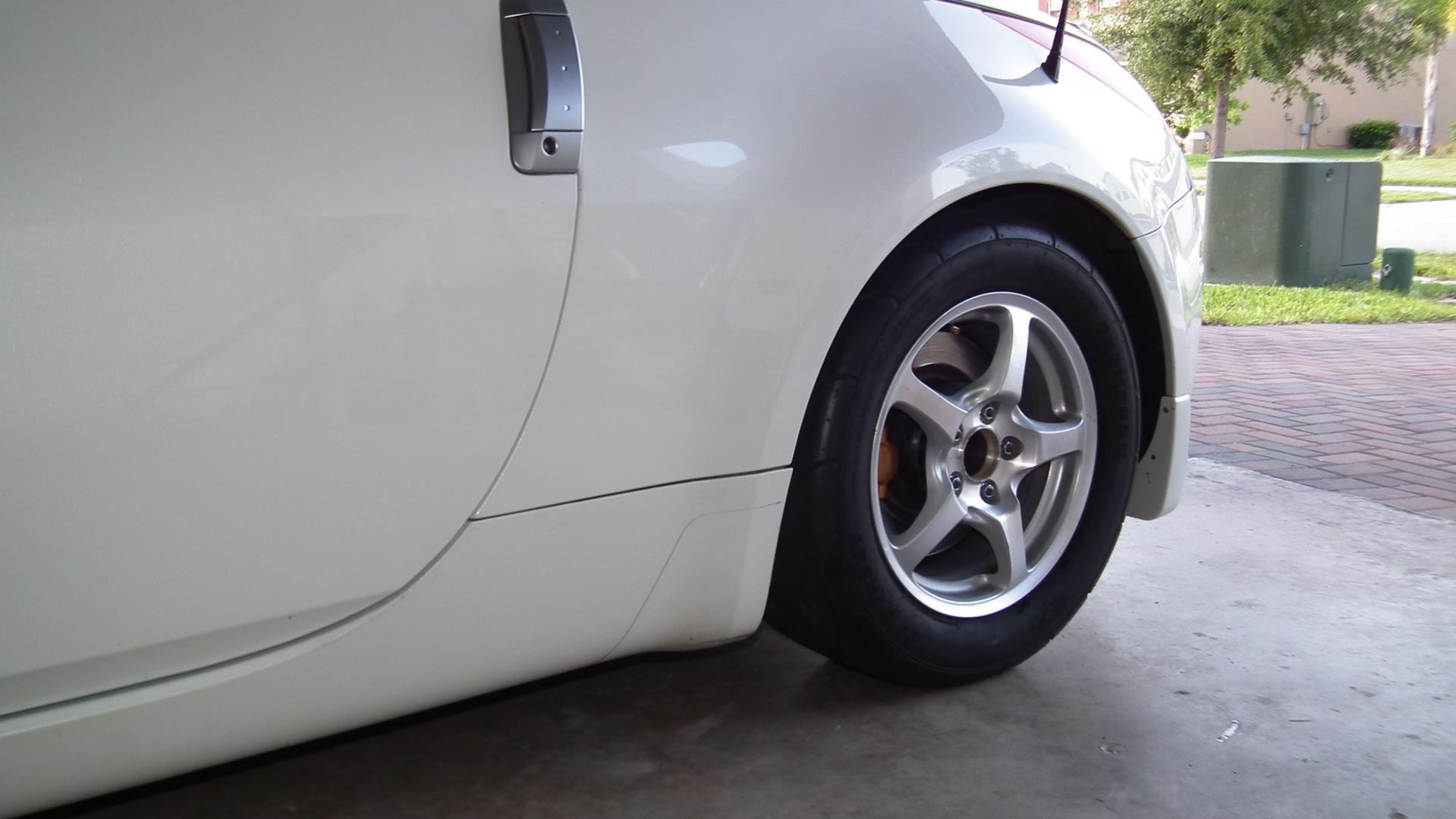

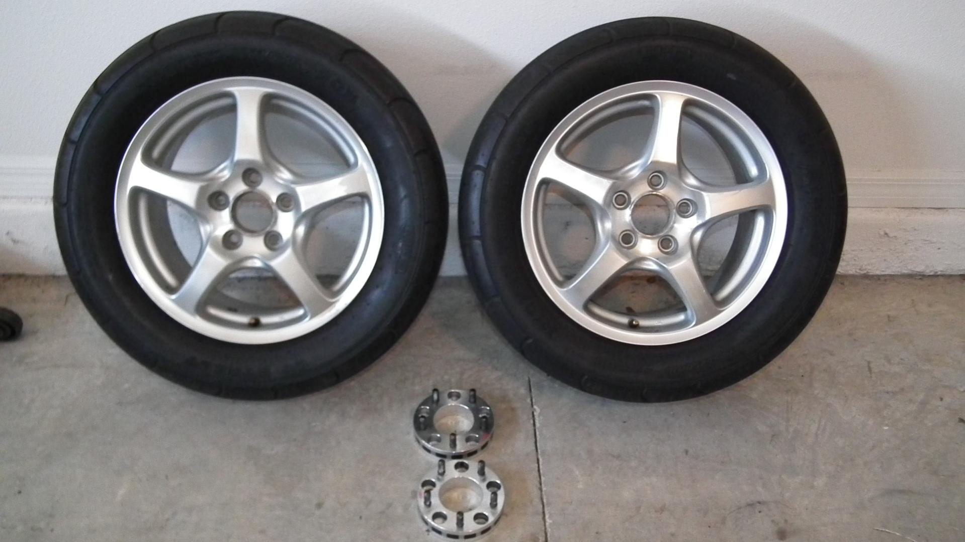

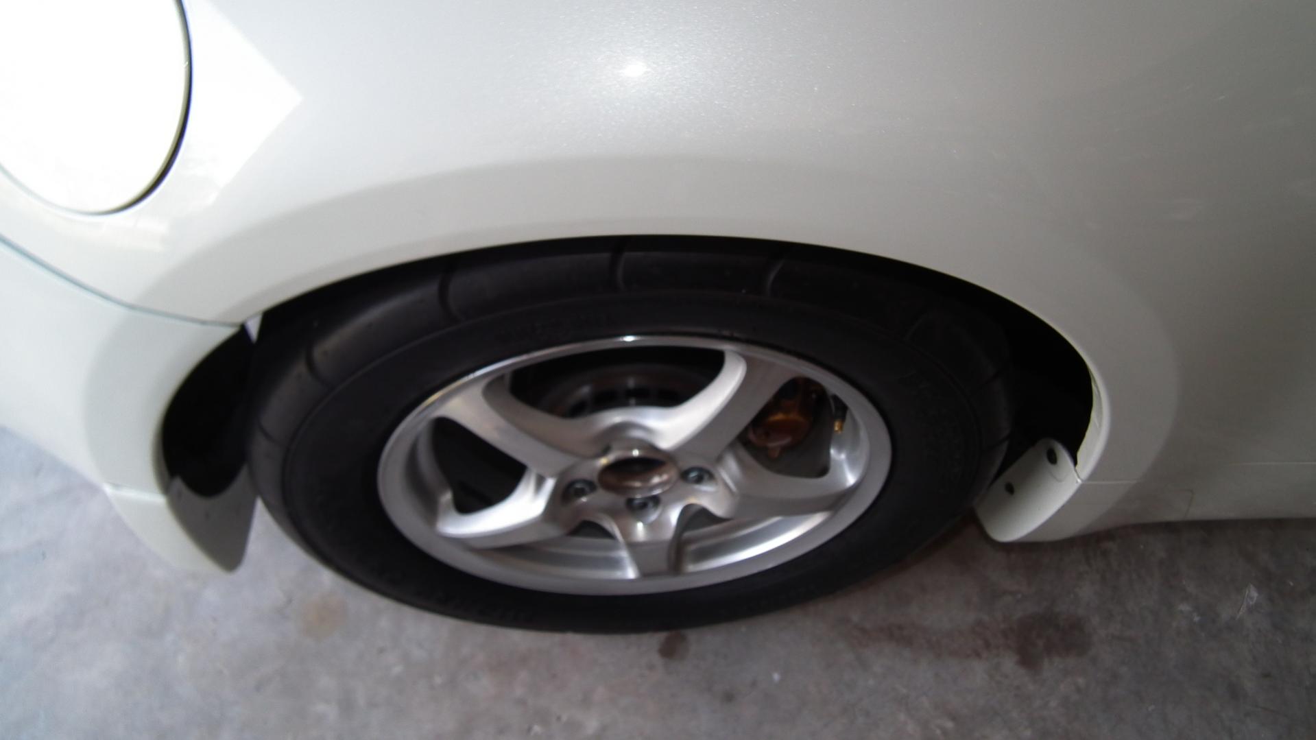

Just to update... I went and purchased a set of 30mm Kicks spacers. The 16" wheels barely clear the brakes. It was so close the paint on the calipers was rubbed off, but no metal contact. Also the tires still tuck in pretty good even with the 30mm. I had to get non hubcentric spacers since the honda S2000 wheels are different than the nissan. I hope to get some pics in soon.... Next, will be the results at the track. I will be heading out Friday or Saturday.

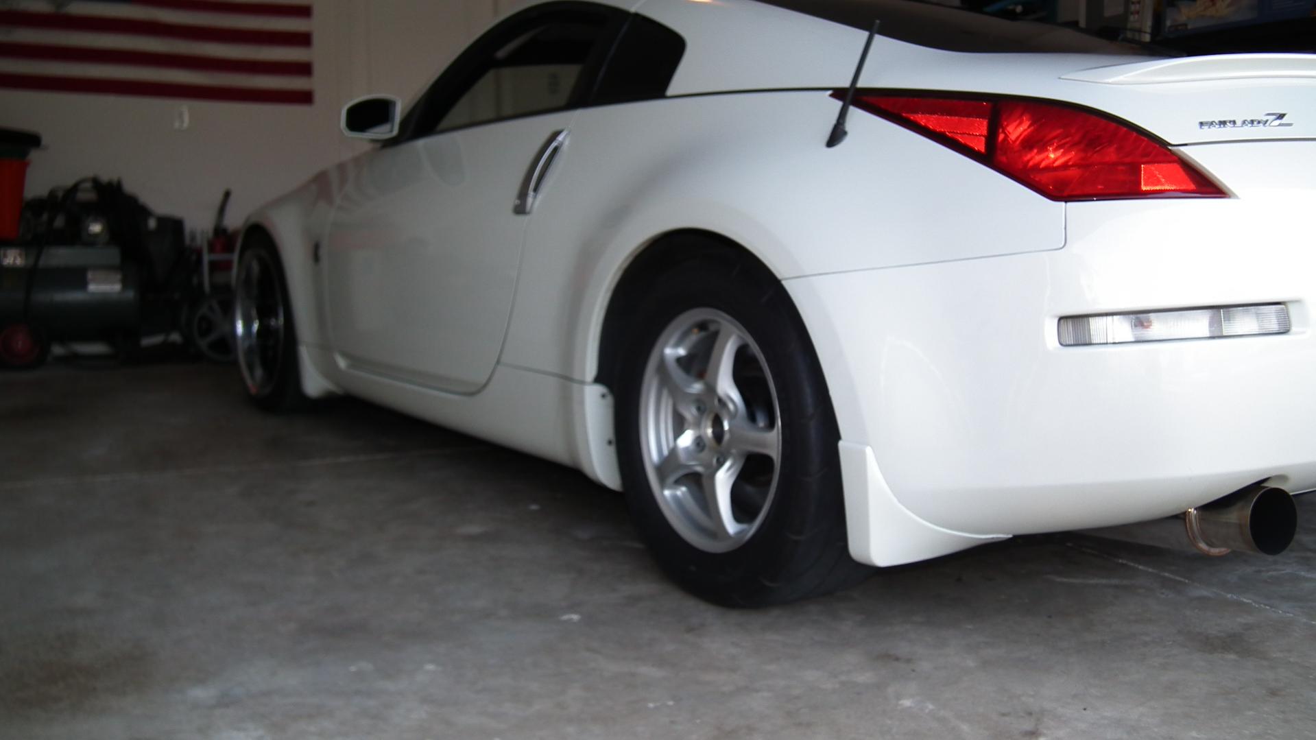

Pics of the wheels and tires with 30mm spacers...
My Z
