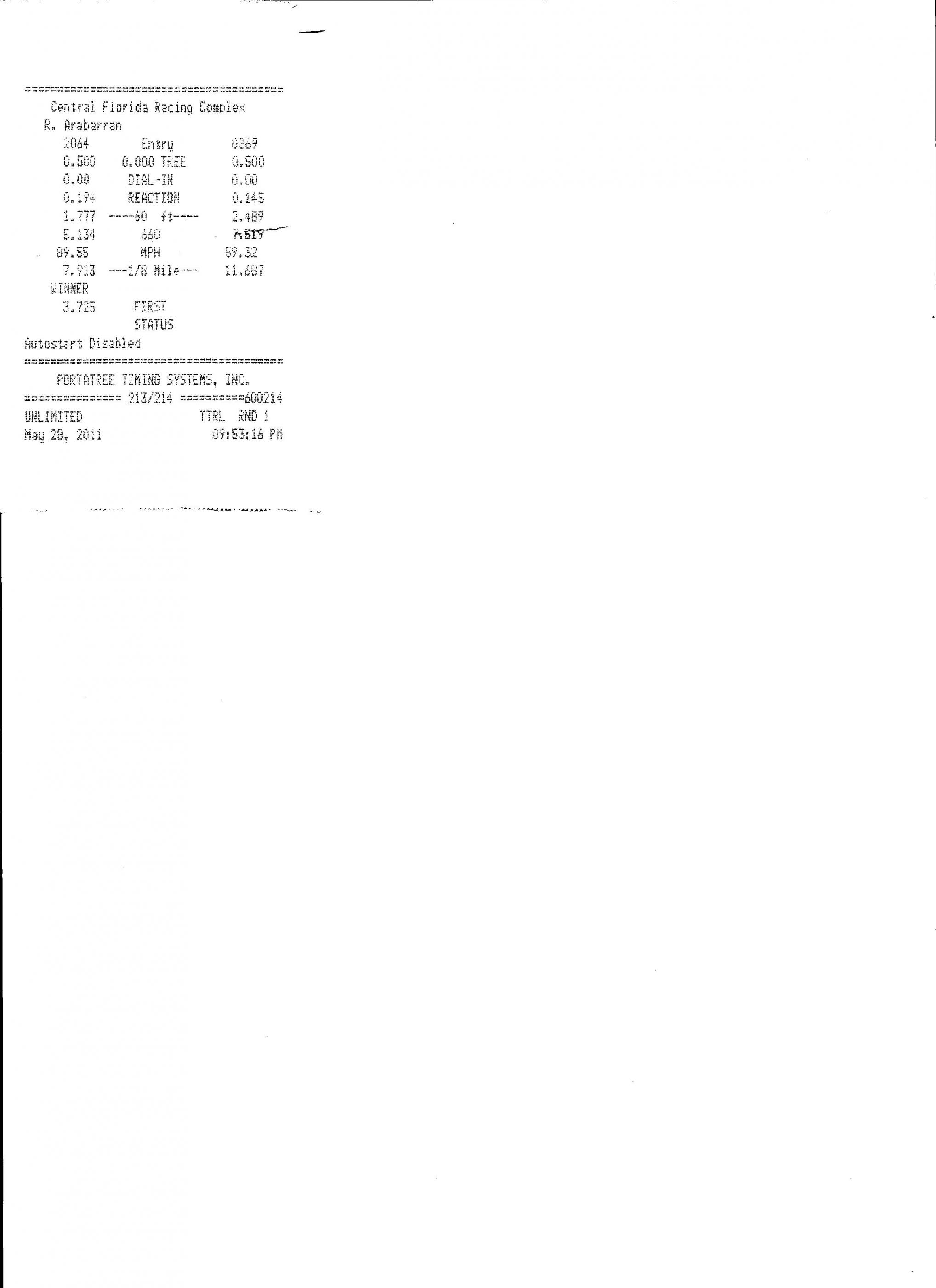

Well.....last night has been my best night out at the track in a while. after a couple of 8.13 runs I finally got a good burn out and a good launch off the line with the help of the track official. I hit a 1.77 60ft and a 7.91 @ 89.5MPH. Man after the 8.1 run I didnt believe it would get any better till now... The weather was good with low humidity and track prep was also good so I guess everything just fell into place last night..I want to thank everyone for all their helpfull input, it really helped me out.

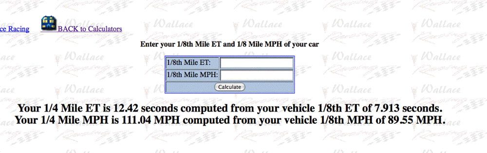

Attachment 315270
Ricer arithmetic gives you a 12.4 second 1/4 mile. Good show.

Very nice....

Thanks guys... Now Im going to tune for 10PSI...and buy some spare axles.. I guess its never enough.
