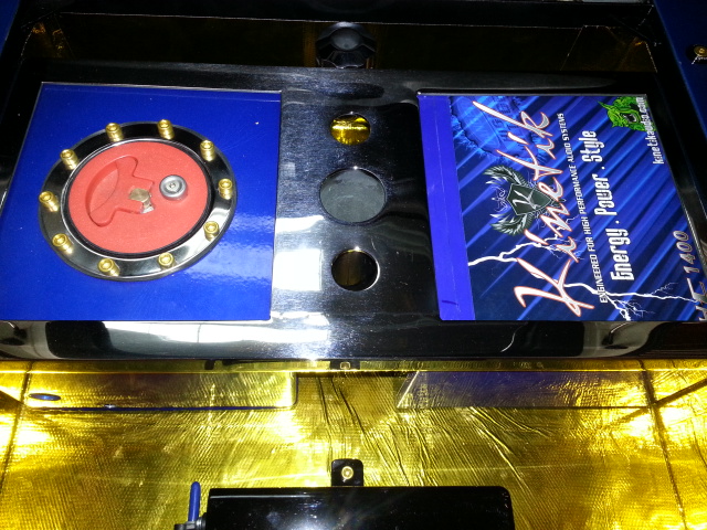

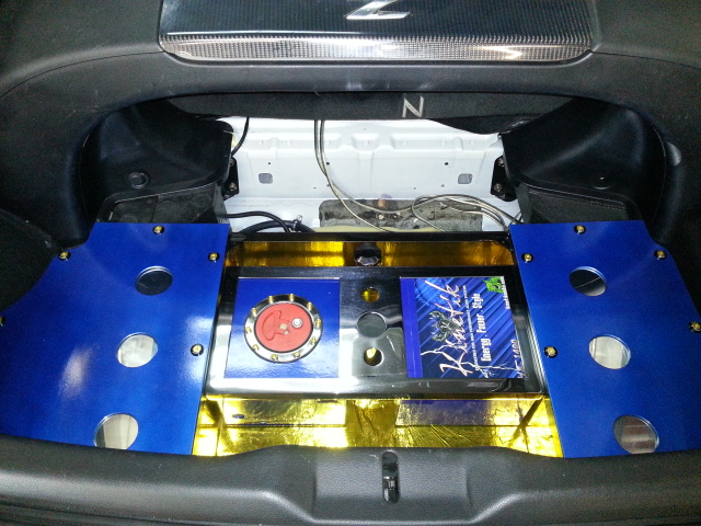

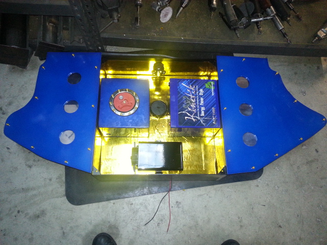

Originally Posted by bealljk
absolutely!
I ditched my AC - but I understand that some people like it...The AC wasnt much more than 35lbs all in (I can't remember exactly) aside from the air flow benefits it removes that 35lbs from the front drivers side of the car.
Another easy modification is to move the battery to the trunk...I fab'd up a aluminum battery basket, bolted it into the trunk. I sourced ~20 ft of heavy duty wire and ran the wire to OEM battery compartment and moved the battery ground to the trunk.
ANOTHER battery to trunk relocation pic.
Attached Thumbnails Less weight = more power; Have you lightened your Z?-water-methanol-battery-trunk-box-3.jpg   Less weight = more power; Have you lightened your Z?-water-methanol-battery-trunk-box-4-niceee.jpg   Less weight = more power; Have you lightened your Z?-water-methanol-battery-trunk-box-2.jpg   Less weight = more power; Have you lightened your Z?-water-methanol-box-almost-complete.jpg
