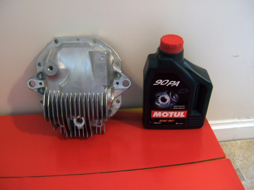

Think heat might be a factor here?
Can't wait for the review
Old Oct 21, 2008 | 11:50 AM
kramerbuccs24's Avatar
kramerbuccs24
Posts: 59
From: Albany NY
Originally Posted by Sponge
^^^^ Like he said.
Problem solved (on the left)
