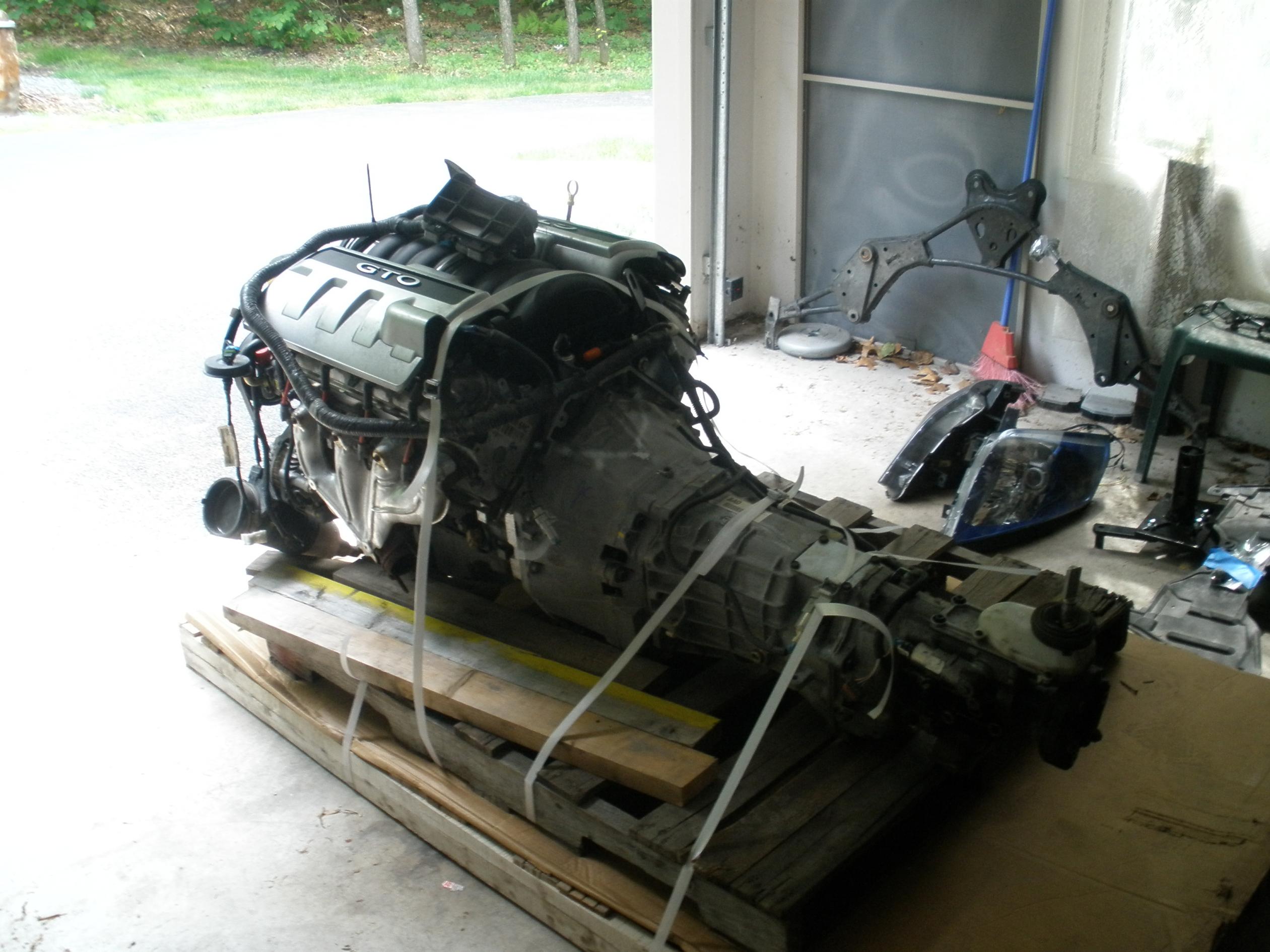

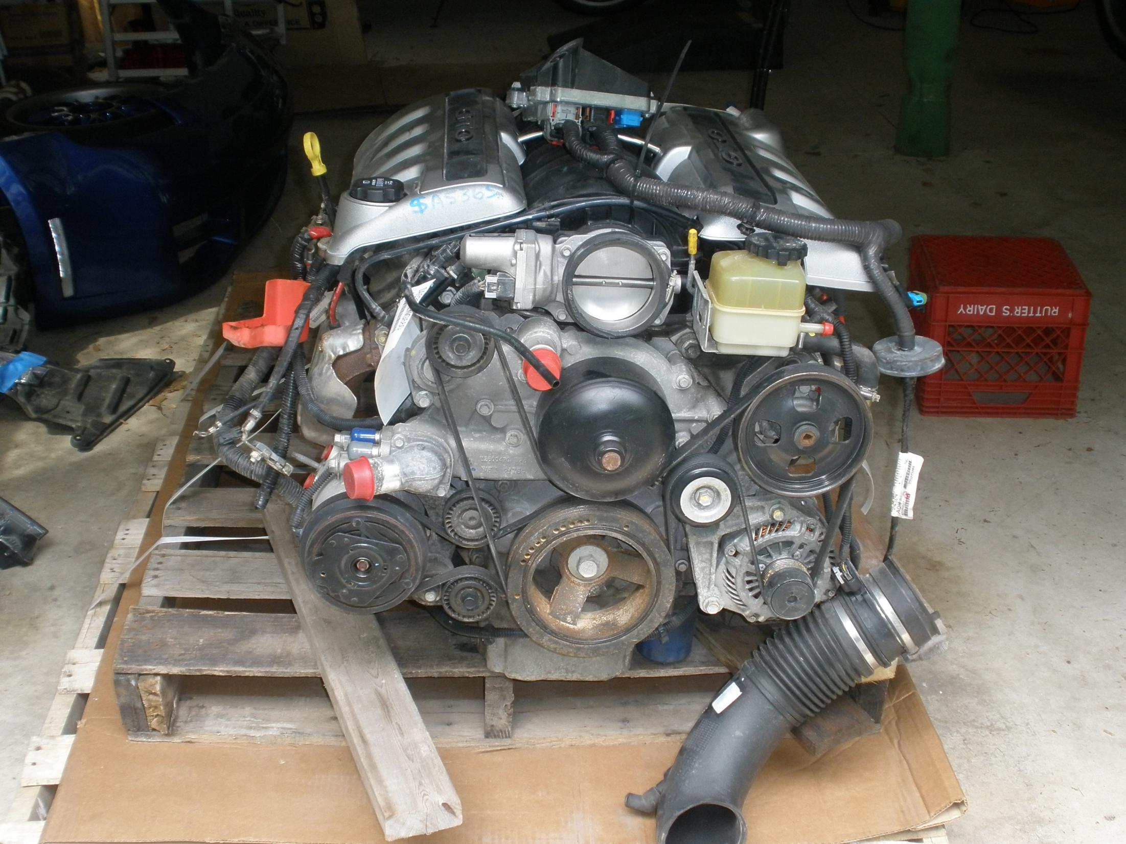

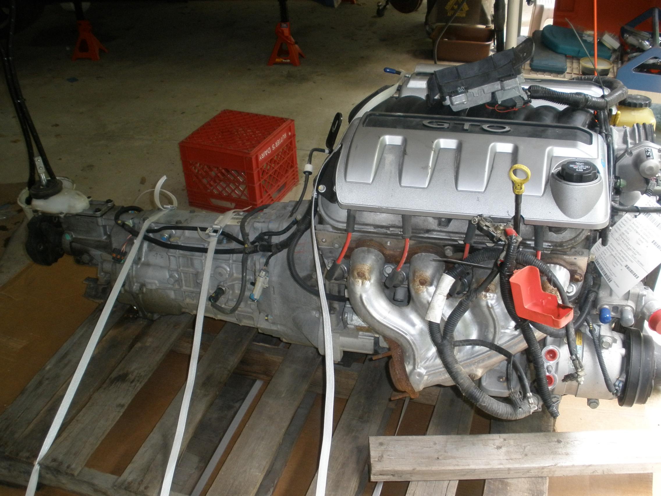

WOOT!!
Sikky 350z/G35 LSX swap-p5121438.jpg Sikky 350z/G35 LSX swap-p5121439.jpg Sikky 350z/G35 LSX swap-p5121440.jpg
Thank goodness I have a box truck with a liftgate or getting this off the delivery truck and back to the house would have been an adventure.

WOOT!!
Attachment 314249 Attachment 314250 Attachment 314251
Congrats! Welcome to the club!

WOOT!!
Very Nice! Welcome to the club.
