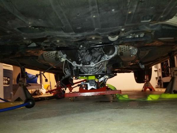

After 700 or so miles of driving, the clutch went soft again when I started the car this morning. It did the same thing as before, the engagement point moved very close to the floor and it was difficult to get into reverse along with a spongy feel from the pedal. After I got off the interstate on my way to work, everything was back to normal again...
The fluid hasn't moved down at all since I topped it off.
During the time it was acting "normal" it developed a "click" or "pop" halfway down(but not on the way up) originating from the master cylinder. I sprayed some lithium grease on the rod, and it went away, but I may have the angle of the rod set wrong or the master cylinder may be bad. I'm going to adjust the angle a bit even though the grease seems to have gotten rid of the binding.
Any thought on how to sort this out? I don't want to throw parts out it, but a problem that only shows up every 1000 miles is hard to chase down.
I also picked up a transmission stop off tool from harbor freight:
http://www.harborfreight.com/transmi...ool-98060.html
It's well worth the $7 and fits right in the back of the transmission to keep fluid from spilling everywhere when you pull the drive shaft.
If anyone's interested, I'll post back here and let you know if the new slave cylinder fixed my problems.

Patrick,
Sorry I missed your post over the weekend and just saw about tearing down for a CSC swap today. I think given the simplicity of the master cyclinder internals and the propensity for even the newer CSC's to randomly go bad I'd say you've made the right call. Even though the master is easy to swap I highly doubt it was causing the random issue you've been seeing.
When it all goes back together make sure the clutch rod angle is set to angle down slightly towards the driver by adjusting the brackets down. If the rod is set on an up angle to the master cylinder you'll get into that bind you were feeling around mid stroke.

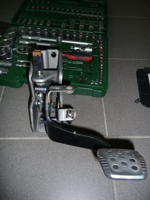

I will keep you posted guys with few pictures of the RJM Pedal with the Wilwood MP !
Just finished my install, everything went well and the guide was clear and easy to follow. The results are amazing, so much easier to shift with a smooth feeling of clutch engagement allowing for easy hill starts and fast accurate shifts with no clumpiness from that terrible spring. definitely worth every penny if you like a good shift! Thanks RJM
Thanks a lot to Ryan ! Nice and available
A real better feeling with the clutch, let tune and test that now !

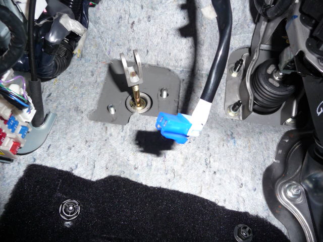

mx594 did you adjust the upper cruise switch each time to extended the clutch rod? If not the pedal would be against the upper switch stop and by threading the clutch rod out would start to depress the master cylinder to some degree all the time. The upper switch plate is intentionally designed NOT to be very stiff so that if one does over extend the clutch rod without adjusting the upper switch position the upper mount will simply flex upwards to stopping potentially destructive clutch damage.
All clutch rod adjustments should be made with the upper switch out or threaded in very shallow so it isn't holding the pedal down while setting the overall pedal height and friction point. There are still 3 main springs in the hydraulic system all working to return the pedal to fully up without need for a 4th. The clutch diaphram is the main force returning the pedal, followed by a return spring in the slave cylinder which pulls the throw out bearing off of the diaphram face when not depressing the clutch, and lastly there is a return spring inside the master cylinder itself trying to push the piston and clutch rod fully out again when not being depressed.
Now I think what is happening in your case is when you pulled the pedal up with your foot you were also flexing the upper switch mount upwards while doing so.
Now for why the pedal goes spungy. If the master cylinder rod isn't allowed to go all the way out to its fully extended position it doesn't uncover the fluid port inside that allows fluid to flow between the pressure side of the MC and the reservior. So what happens if this port is always held closed is that fluid can't move to or from the reservoir causing the friction point to rise higher as the car gets hot and fluid expands. Then in the morning when cold the fluid will have contracted overnight making the pedal spongy and the friction point very low until things warm up or as you discovered by forcing the pedal up against the upper switch that you opened the transfer port long enough to restore proper MC operation and the friction point immediately came up.
I would suggest going back to the install guide and reset the pedal height, get the friction point set back where you like it and then re-adjust both switches so that they just click plus a little more. However if adjusted properly neither switch should ever be depressed to the point where the white ruber bumper is hard up against the threaded body of the switch.
Hope that helps

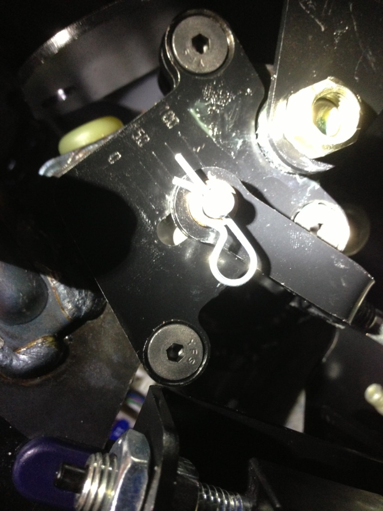

The actual percentage is meaningless as it is simply an easy way to describe how the adjuster is set.
0% is the same as stock. No change to the factory fulcrum length.
50% is simply 1/2 of adjustment range I built into my adjuster.
75% is where I recommend everyone starts as I found this to feel the best for the most customers.
100% is simply the maximum amount my AFP adjuster mechanism can physically move the fulcrum point (where the fork pushes from) on the arm in relation to the upper pivot point.
75% is simply a place to start as most will play around with this setting up or down to suit their own personal preferance in clutch feel or adjusts based on their specific engine and clutch setup.
