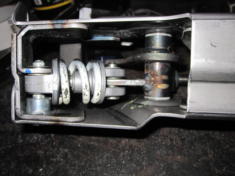

Anyone got a pic of the stock spring in place?
The spring is located under the pedal..easy to spot.
Crawl under the Clutch pedal and use a flash light...take your time.

OK, thanks, i'll have a look for that, hopefully this weekend, i'll be surprised if it's still there as i can feel the clutch reasonably well.
I'm sure you'll find a spring...only this mod eliminates it .
Try using Liquid Wrench in there to start..if you don't like it..do the mod as indicated here.
Yeah.... there's a spring
I assume you mean spraying lithium grease on the push-rod?
Old Nov 8, 2012 | 03:50 PM
Spray in on the rod shaft and ALL OVER the moving parts in that pic.
Spraying the spring itself won't do anything..but you're going to blast it anyway.
