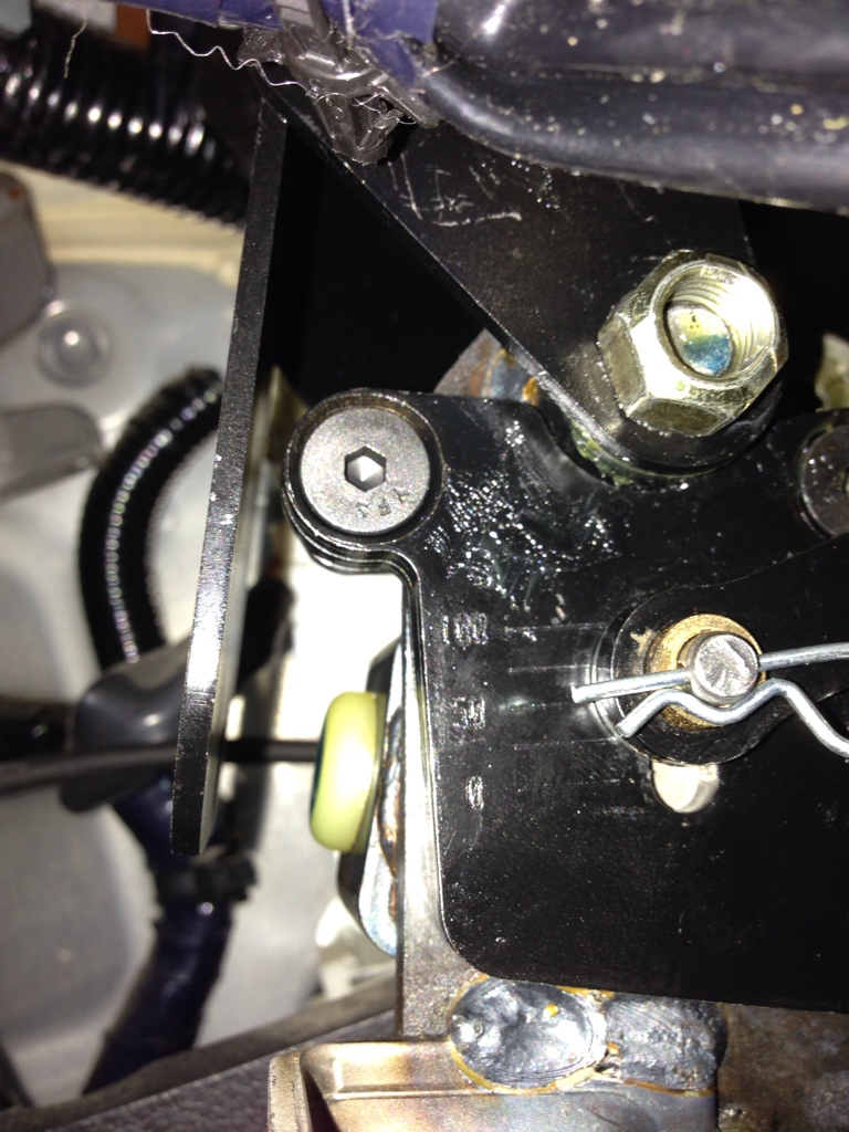

Ok I have an issue that seems to keep popping up after I had installed the pedal system. In the mornings it is extremely difficult to get it to go into any gear when I have the clutch fully depressed.
Diesel350, how low is the friction point set? Sounds like it could be two things. First ensure the upper cruise switch or upper stop bolt isn't holding the pedal down at all. Second I would suggest going back to the install guide and follow the friction point setup while the car is cold. If the cold friction point is less then 3/4" to 1" up from the floor it won't pass the tests for complete disengagement per the guide.
Go back and check out those two items and let me know how it goes.
Ryan
Not sure how low the friction point is set, I will have to check and get back with you.
Below is the view where the pedal shows it is not being held by the stop bolt. Also, another thing is that the pedal feels loose, I can move it around with my hand easily, is this normal?
For the friction point I would start by adjusting the clutch rod 1 full turn clockwise while facing the firewall to raise the fulcrum point some.
For the pedal being loose it looks like the fulcrum nut is barely engaged. The fulcrum bolt should be rotated until the flats on the bolt line up with the flats in the bracket so that the bolt can push down fully. Once the bolt is fully thru you should have threads sticking out of the lock nut. Next tighten the lock nut down until the loose play is just gone but the pedal can still move freely without the bushings getting pinched
Thanks, that worked. Now it shifts smooth as butta.
