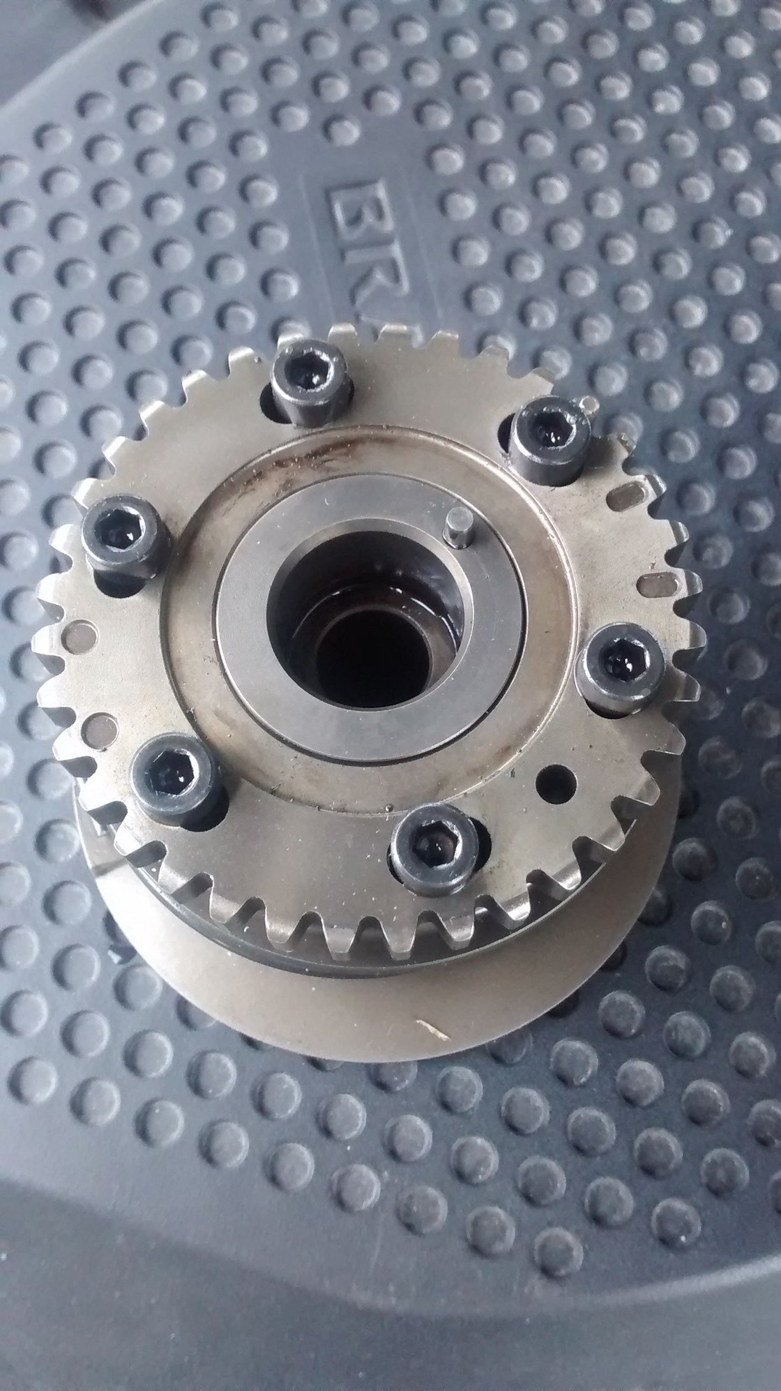

Ok,
so I have the revup motor in my car. I am almost positive what to do now but I want to double check. What I have circled in blue I should take off the revup motor. I should then replace that with the bolt that is in my old motor. I will then take the timing cover completely off the revup motor and put the timing cover from my old motor on it. Also there are 4 cam sensors on the back of the heads. What 2 sensors should I hook my wiring harness to?

I wish I had more parts available in front of me to look at. I know rev up cams have been used in many non rev builds, so I know it's possible. The cans from my spare motor were sold to someone doing this. I haven't done this myself, my rev up to de build is going to have aftermarket Non rev cams.
Swapping you your Non rev cams is easiest , but you have the rev up cams to run.

From: new bern nc
You can use the intake cams with either cam gear. And you can even use the exhaust cams with the de gear but you need a different bolt as the threads are deeper inside the cam and the stock bolt isn't long enough. I think I was told a vq30 bolt would work

I purchased the car about a week before the engine starting knocking. It had low oil pressure when purchased.
I was able to locate the bolts I needed at a parts store.
Engine is running like a champ.
