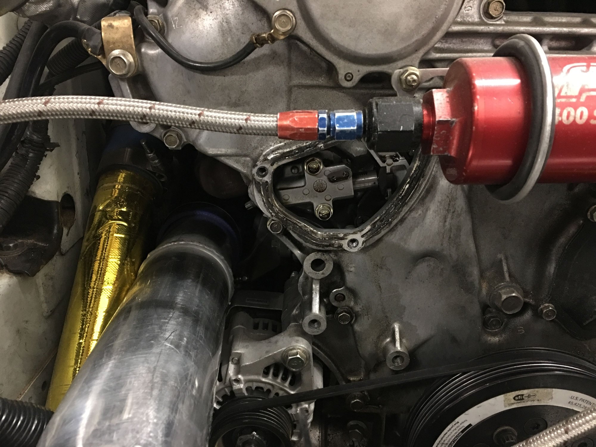

I dont disagree with what nissan is saying and even a new tensioner may not fix this - even short term. If it was me, and not that I'm some master mechanic, but I'd drop a new/newer tensioner in it bc it's pretty easy...Nissan made the tensioner easy to swap out to simplify a water pump replacement.
it takes 3minutes to expose the tensioner and a half hour to get it out & a new one back in...
