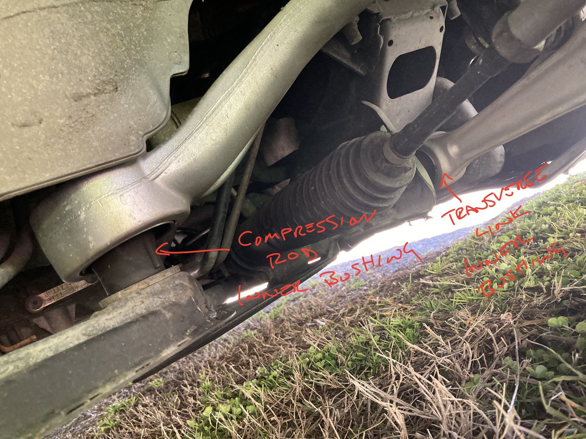

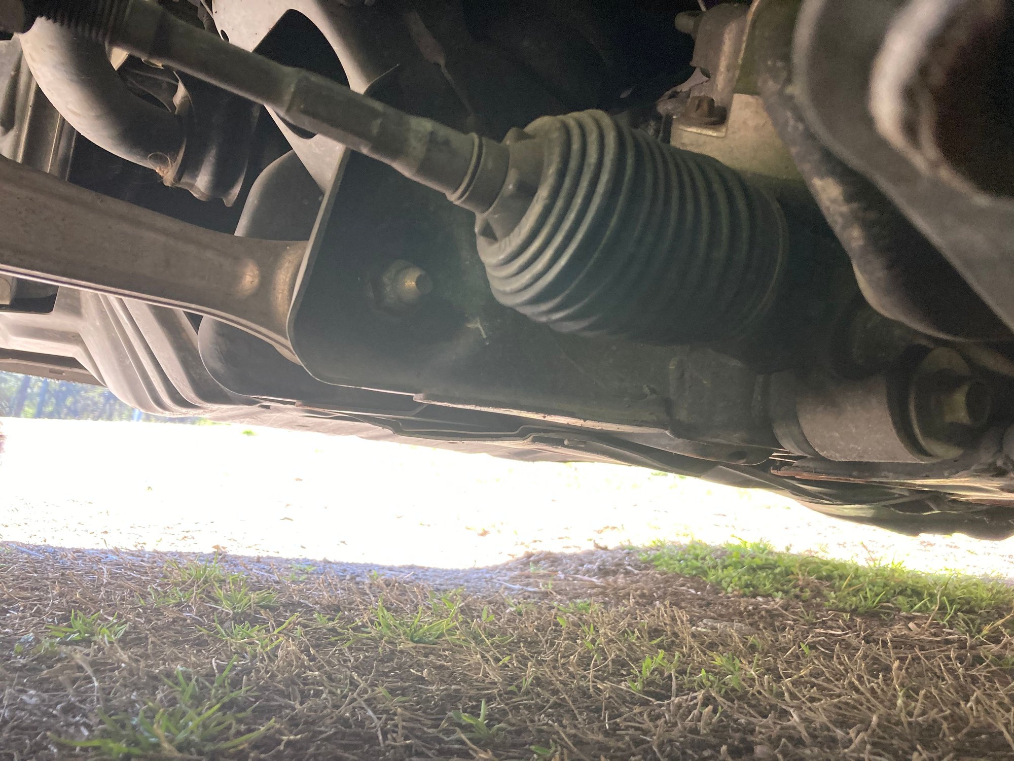

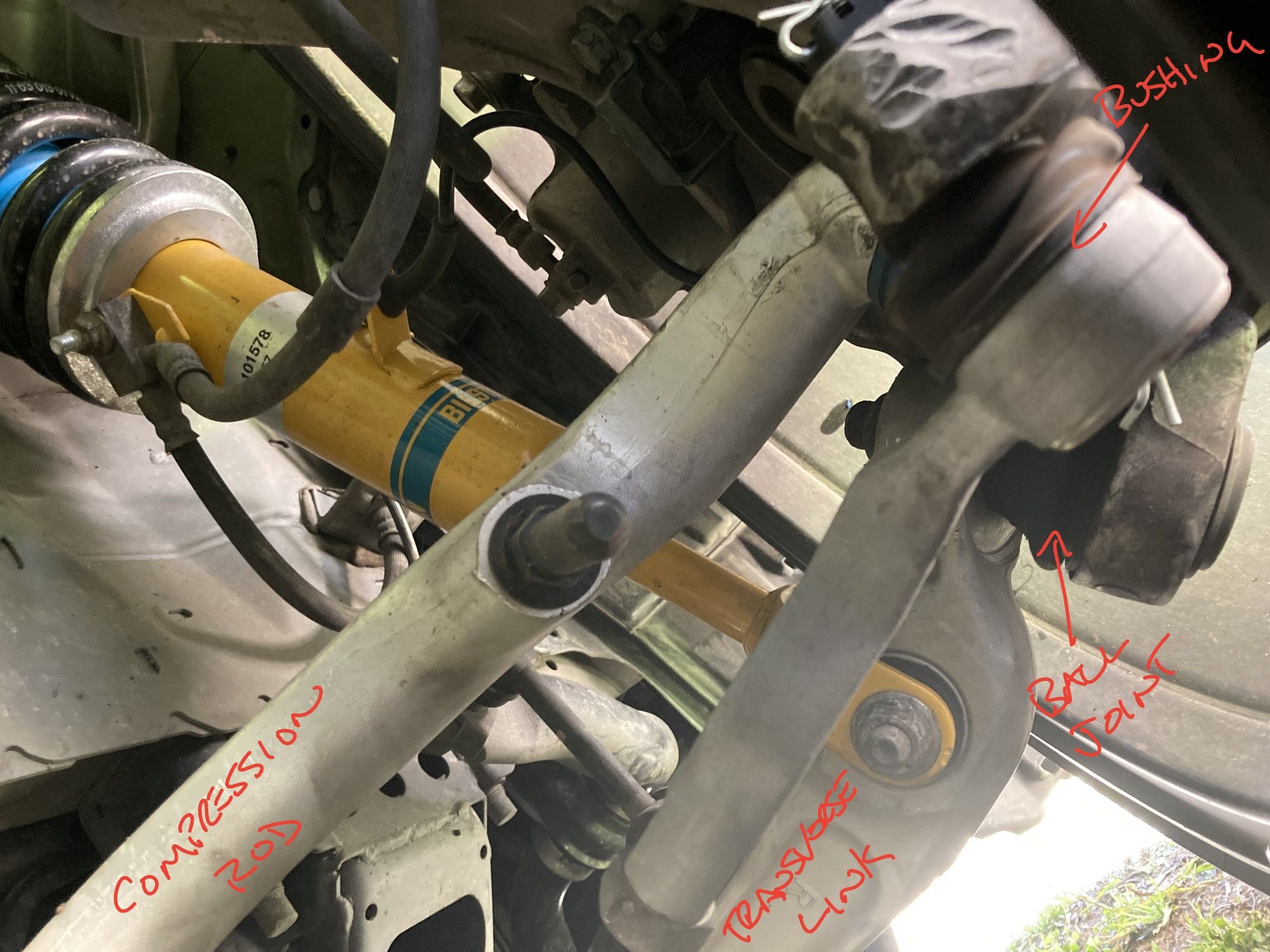

Well, I still havent ordered arms. I just emailed fdfraceworks after reading good things, and they helped me pick what is best for road racing. It is a little pricey in my situation, but I was hoping to just change them once, and have some really nice parts. The rear grip kit relocates the knuckles of the control arms, and looks complicated. I did talk to the most "race" shop we have down here that does the specialty alignments, and they said they could definitely install it and align it. I may change my mind and get another brand. I really was hoping to get the best though, and act like price isnt an issue; even if it delays me a few weeks.
Im going to look up what that bushing is, because i dont know what im looking at in your picture. Here is some photos of mine. I noticed that plastic spring shaped thing, is compressed on driver side in last photo.. Im kind of flat, but passenger side slightly parked uphill
the last two are driver side first two passenger

Your front suspension bushings are done and your lower ball joints don't look too good either.
If you're getting new upper control arms, those should come with bushings. You just need to get some new ball joints, transverse link (lower control arm) bushings, and compression rod bushings. I would have hoped that the suspension shop that put in your B12 kit would have said something about the lower shock bushings on the transverse link if those were shot, but they didn't tell you about anything else, so I would replace those, too.
However, I think the first priority should be to fix your door handle/lock problem so you don't die from heat exhaustion like some poor dog or child left in the car on a hot summer day by some negligent parent on a quick trip to Walmart.

Here is the bushing kit from Z1
Okay awesome thank you. I asked fdf raceshop, and did plan on getting two arms for front. One is called "front adjustable control arms". (says includes lower control arms and radius arms) other is called "upper control arms".
So im assuming i still need new ball joints and compression rod bushings. Would the transverse link bushings be included with the "front adjustable control arms"? Im hoping i can get it all done at once. I may take pics of rear, even though it feels fine.
Yes, need door handle fixed.. I may wait on it though! as of today i have all battery supplies, so will try to make sure its connected properly and tied down, myself. Then i will always keep my phone charged and on me, until i get it fixed. I wish i could fix it myself but may leave it to shop.

Sounds like the "front adjustable control arms" are the transverse link and compression rod, but I don't know for sure. Probably need to ask them. While you're at it, ask them if new bushings already come pressed in and installed.
The front upper control arms or FUCAs should have bushings pre-installed as well, but I would double check on that.
I've never heard of this "FDF Raceshop" outfit. I googled it. It looks like they're out of Canada. Their arms use helm joints with solid machined spherical bushings. That's likely going to be a lot of overkill for you and increase the NVH (noise, vibration, harshness)in the suspension. It will be a lot firmer and minimal flex, but at a price for comfort. They look pretty overpriced, too, but I know you got money to blow.
