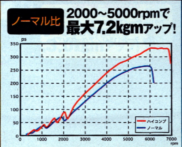

in the most recent option magazine, there is a review of the Esprit 11.5 CR engine build up.
spec as far as i can tell:
11.5 CR pistons
Plenum spacer
Ti headers dia. 60 (tried 70 but lost torque)
Exhaust midpipe
Cams (think they are 272 but not mentioned in the artcile)
New Valve springs
ECU reflash (not mentioned - but safe to assume since they sell reprogrammed ECUs)
Total cost - including wages about $10K
interestingly they mentioned that they are working on a 4,320cc build-up, initially focused on the a stock bore build up to provide a cost effective NA solution

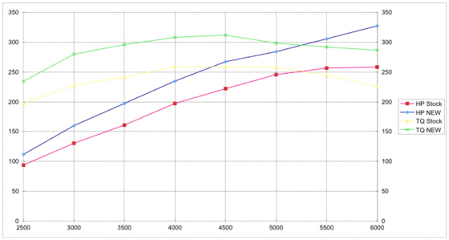

here is a quick and dirty attempt at looking at the tq curve by eye-balling the hp number on chart (i did convert ps to hp)

wow, look at that torque curve! The more I think about it, the more intriguing it is to do an all-motor build up... my next step is going to be Headers/Cams and then we'll go from there... 325 N/A HP with that much torque down low would be about the equivalent to a Stage 1 Stillen supercharger (without the ugly *** hood, of course)
Exhaust midpipe
This is interesting data. I assume you are saying this engine has titanium headers with 60mm collectors (2.36"), and that they tried 70mm collectors (2.75") but lost torque.
If true, this means that running 2.50" pipes from the cats to a 3.00" center pipe (Y pipe dimensions) on a stock or near stock engine would certainly hurt torque.
Do you know what diameter mid pipe was used?

Since this is an engine build-up, is that curve from an engine dyno, or a rear wheel dyno?
yes the article says they use titanium headers with 60mm collectors.. they sell a SUS and Ti version per their webpage
http://www.esprit.to/tuning_plan/fairladyZ33.html
don't know about the size of their mid-pipe.. buts more like a y-pipe and mid-pipe combined design..
not mentioned in the article but the stock figures look like a wheel horse power numbers in PS units.. so it would make sense for the build-up numbers to be on the same basis

Theres no way that is correct. Those torque curves seem inflated. I don't see how you'll are making 200 lbs of torque at 2500 rpm stock.
whoops you are correct.. must be a typo in the equation probably used something like 5552 instead of 5252..
