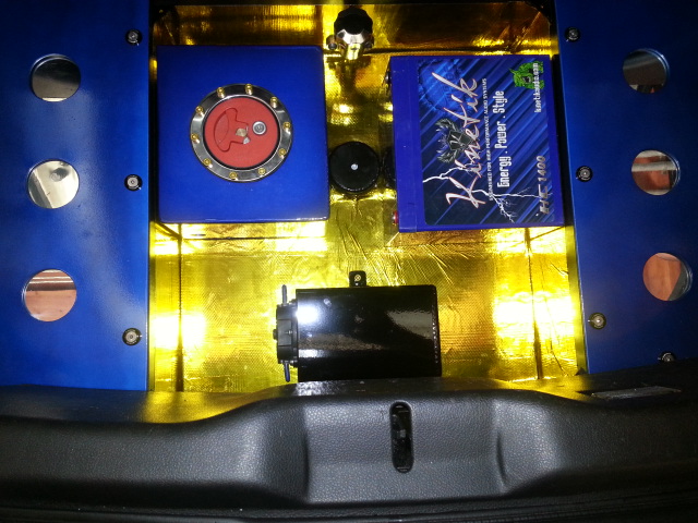

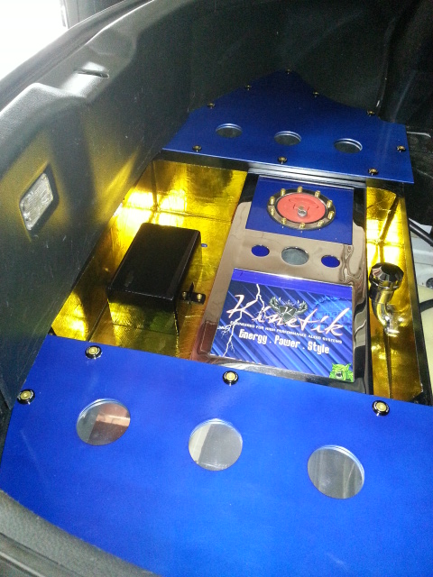

Originally Posted by Lucino
I regret so much that I didn't buy the suction gun. After I drained the trans oil I had a hard time filling it with just a tube and a air pump.... I ended up spilled oil all over the place so do your self a favor and get a suction gun.
I only drained about 3 quarts of trans fluid, was this right? The manual said four quarts.. did I leave another quart behind?
OR...make yourself (or have made) a remote diff filler as I did....It's the polished silver 90 degree necked pipe with chromed top in front of the water/meth tanks....
Attached Thumbnails Changing the Differential / Transmission Oil-water-methanol-battery-trunk-box-3.jpg   Changing the Differential / Transmission Oil-water-methanol-battery-box-90-percent-complete-nice.jpg
