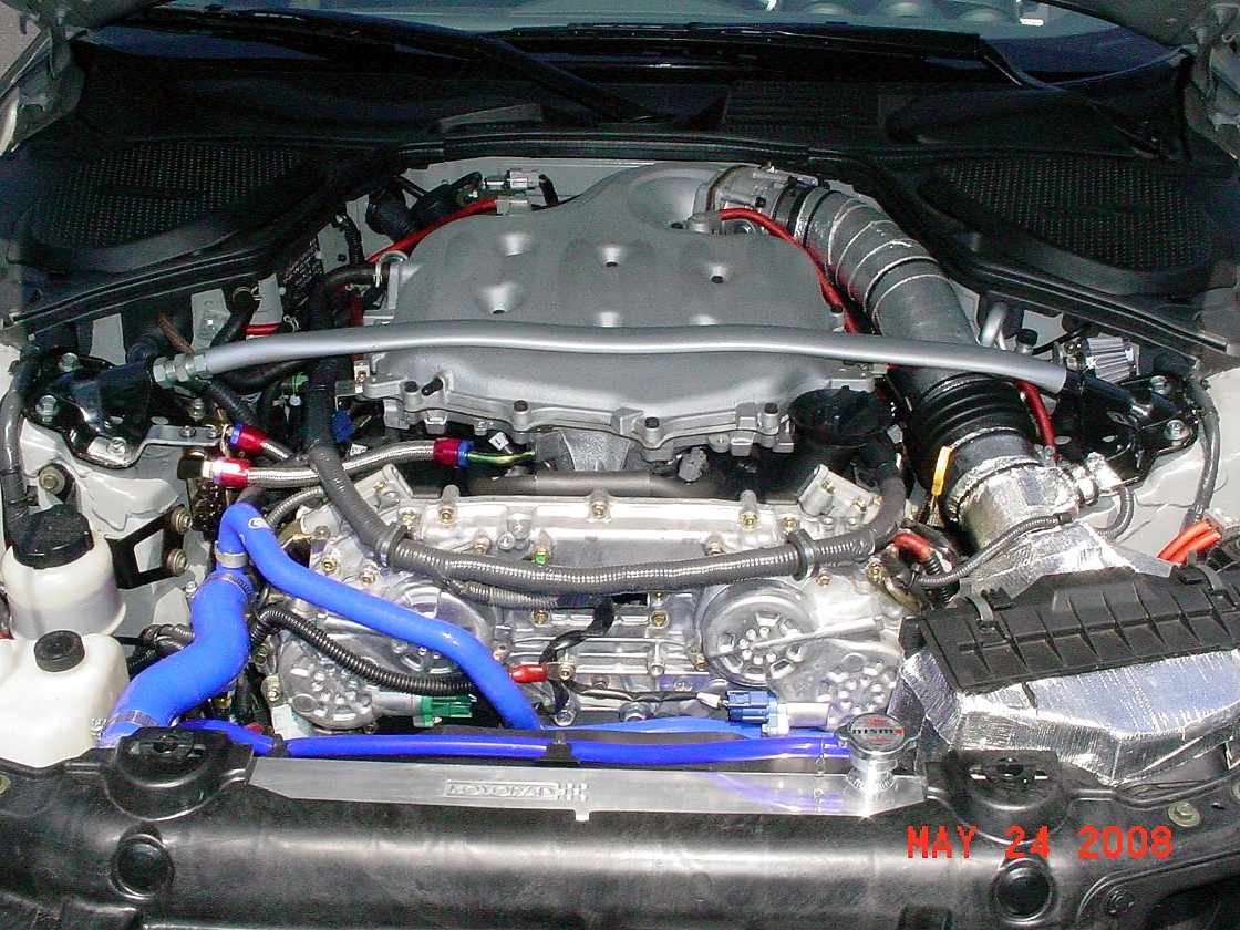

Originally Posted by gothchick
Was bored today... Fabbed up a bracket and switched to stainless hose with anodized fittings. I've been running this catchcan with stainless mesh for about a year. Totally happy with it. I cracked open my plenum last weekend just to see how well this catchcan has worked over the last year, and it was spotless. :-)
that looks good, where did you get the anodized fittings from?

gothchick looks great would look better if you atleast took a sharpie to the brass fittings.

Great minds must think alike... Lol. I blacked them out about a week ago. :-)
Escobar: I got the fittings from Custom Corvette Accessories
http://www.customcorvetteaccessories...lcatchcan.html
