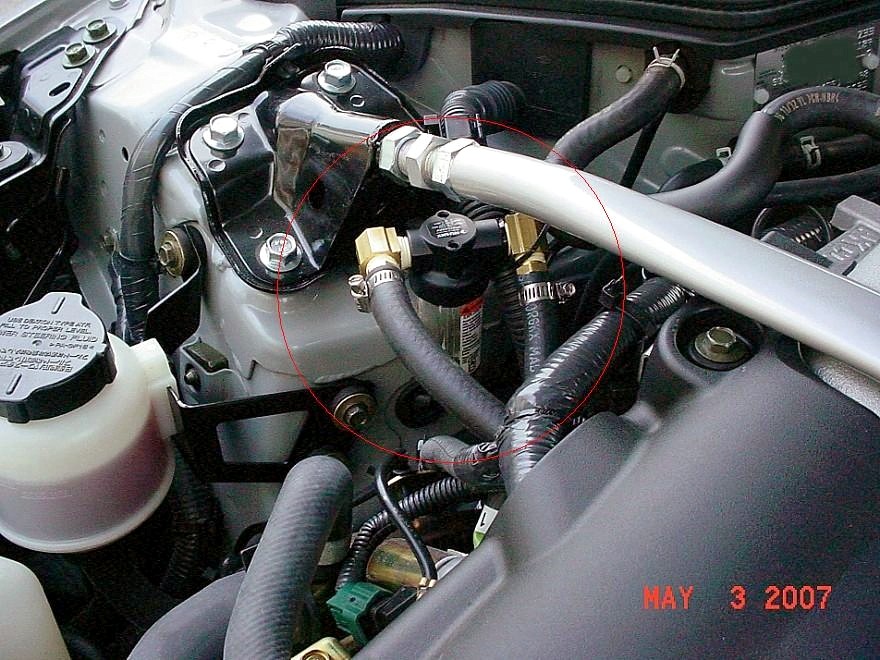

Update:
Hi Guys~ I did this mod this weekend per the above DIY instructions. Parts cost about $25USD at Home Depot, fuel injection line was a couple bucks at Auto Zone, and took me about 45 minutes to fabricate & install (I'm sure someone with more experience could install it faster). So far it's working great.

Originally Posted by XuperXero
Bought all my stuff, I came upon a confusion when installing. I noticed when I opened the cap, I saw the outlet/inlet to be different designs. Which way are we suppose to route it to?
I'm guessing crankcase to the flow as show in attached picture then to lower plenum... since I looked into the hole and it points straight down. The OP routed it the other way though.
*note* one nozzle is shorter than the other
Air comes out of the crankcase, goes through the can and out to the plenum. You want the arrow on the can (there should be an arrow stamped on top of the can) to point towards the plenum. The arrow indicates the direction of air flow.

oops... I mounted it in reverse then..
But it seems to collect oil fine.. should I even bother switch back around?
Old May 3, 2007 | 02:49 PM
  #51
gothchick's Avatar
gothchick
Posts: 3,300
From: ATL
You're probably okay... Might wanna keep an eye on it to make sure though.
