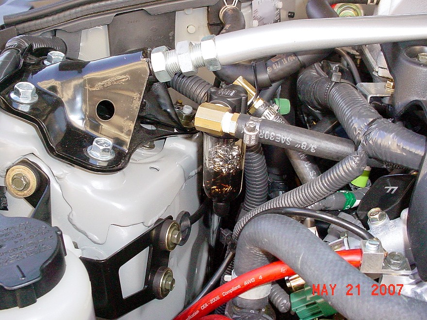

Well, I've been running the mesh inside the canister for about a week, and it is definitely catching more oil now... :-) And just think, without a catch can all this blow-by would be sludging up the plenum, and going into the combustion chambers... YUCK!!
I'd really like to thank i8acobra for posting up this great idea for a DIY catch can!

To drain it, you just take that nipple thing off the bottom?
Old May 25, 2007 | 12:29 AM
  #64
XuperXero's Avatar
XuperXero
Posts: 2,084
From: Toronto
You could. But it's much easier to twist it off from the cap and poor it out.. much less of a mess and easier to do rather than pushing that thing with a screwdriver and letting it drip out.

Originally Posted by gothchick
My catch can didn't seem to be catching much oil, so I thought I'd try an upgrade. I put some coarse stainless steal 'pot scrubber' mesh in the can to give the oil something to condense on. It seems to be catching more blow-by now...
Is your catch can supporting itself off of the strength of the tubing, or is there a mount somewhere that I can't see?
Old Aug 23, 2007 | 12:46 PM
  #72
gothchick's Avatar
gothchick
Posts: 3,300
From: ATL
Yeah, it basically does support itself on the strength of the tubing (since it's a short length of high pressure tubing). But I also zip tied it (snug, but not too tight) under the strut bar just to make sure it doesn't move around. Been running this mod for several months now... Works flawlessly. :-)
