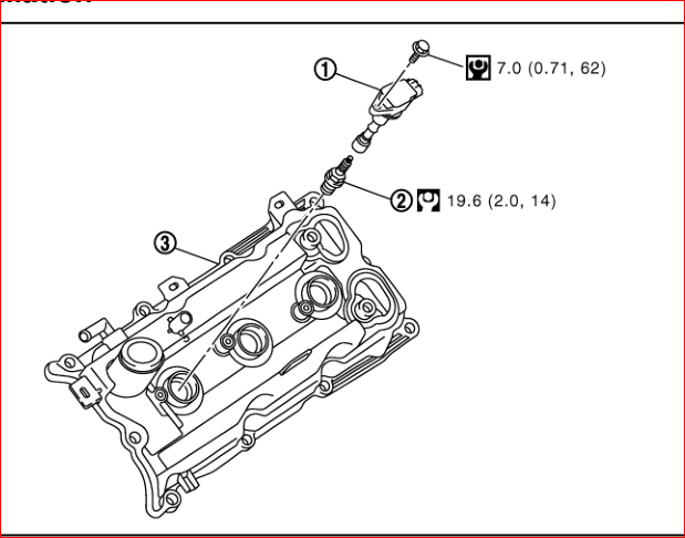

That seems weak for plugs too
But I did this job and didn't tq anything
Only things I tq are my lug nuts between sessions know track

Are these pictures reading a different measurement than ft-lbs?

sorry here is pic 2. I thought it the torque specs always read out like this N·m (kg-m,ft-lb)

The TB and small bolts like that are in in/lb, they aren't that tight. They only go into plastic manifolds, if you try to get them that tight you will break the bolts or pull the nut out of the manifold.

If I'm not mistaken the black wrench with white background is in/lbs, while white wrench with black background is ft/lbs.
