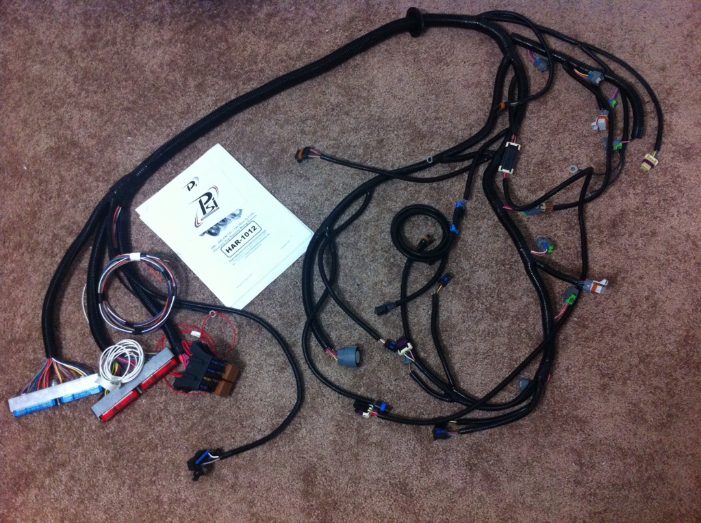

With the wiring harness, there are other companies that have a good product...we have seen diebold autosport, currentperforamance and even speedscene wiring. I was going to go with currentperforamance but went with PSIconversion. They as well have a good product as it seems but the proof is in the pudding once it is all systems go.
Turnaround time is quick. I ordered on Saturday, shipped out on Monday and here yesterday. Given they have it instock and any needed modifications they will do pretty much the same or next day as in my case.
Plus they worked with me on the weekend, I left a message Friday night and they gave me a call back on Saturday to discuss my build.
NOW I am posting this cause if any company handles their business like this then they are in it to win it.

It has a DLC connector and all the underwire for the dash/gauge hookups. I am going to attempt to use the stock tach and figure it out' if it becomes too much a headache then I will use a speedhut tach.

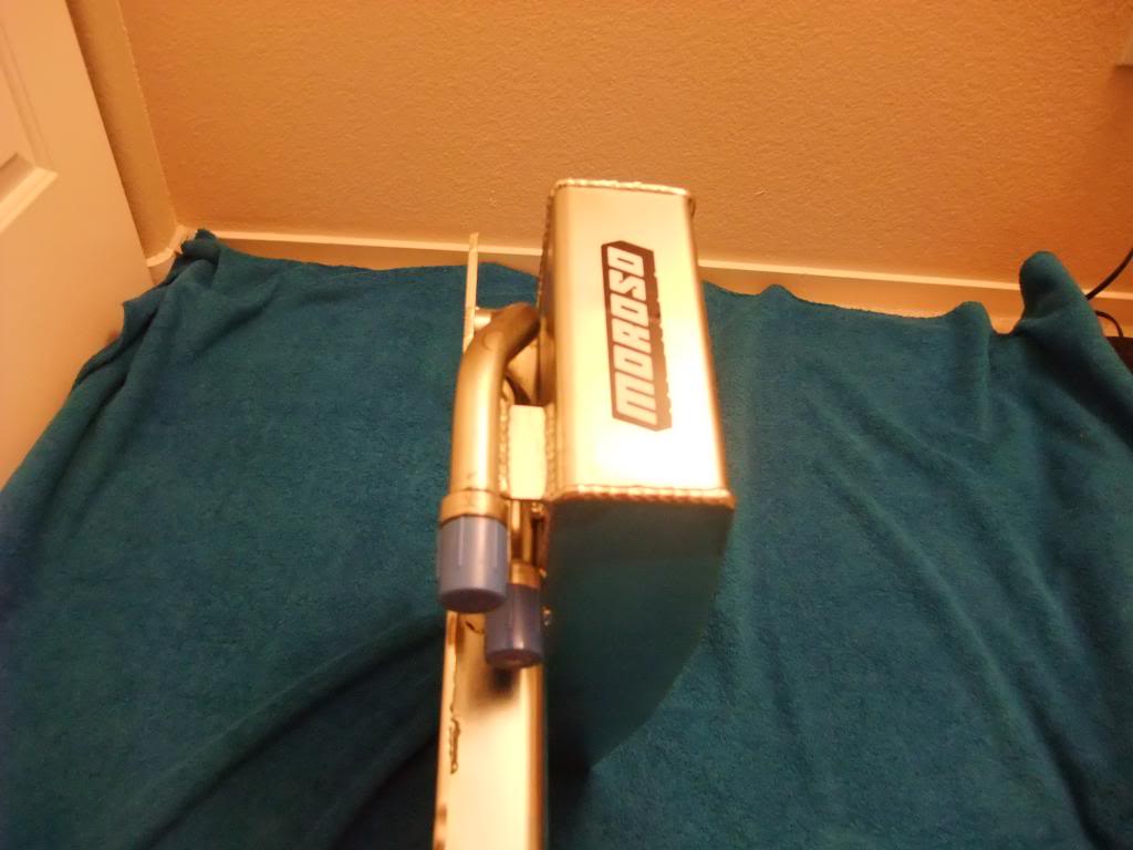

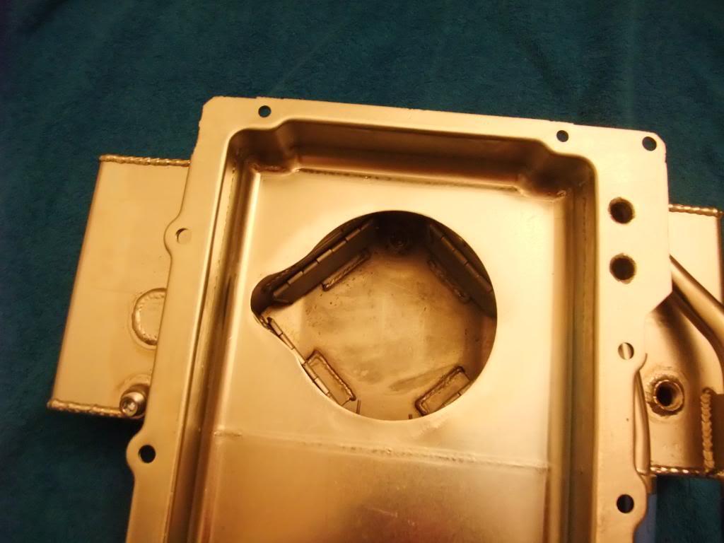

After having my fueled racing kit since since spring I finally went to mock it up myself . Alas, I'm sure they sent me the wrong one...they probably sent me a s chassis kit. gonna give them a call on Monday.Funny I just now noticed it....

well just got with Logan who also has the FR kit this is how it's made so the way I had it mounted was right...nothing against FR but ill end up modding the mount for my liking
Just got off the phone with Todd at FR and all is good now, just needed a pic to be sure of mounting point(confusion on my end). I am going back to the shop on Monday to refit, also since I have a 4L80e there is no mount available for it from FR. Todd advised me to mock it up with the standard tranny mount that comes with the kit and make a template with the 4L80e and he will me make a new one for free and have it available with their kits going forward. AWE-some!!! to FR

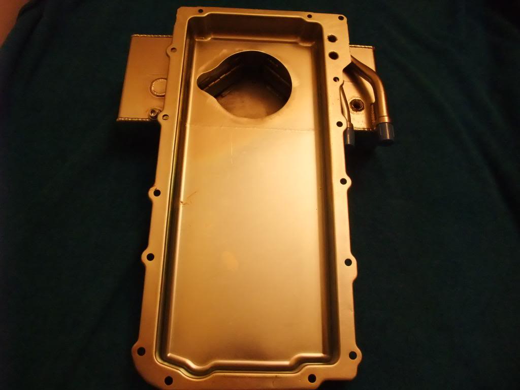

pics of the FR oil pan made by Moroso;

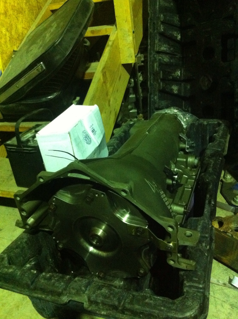

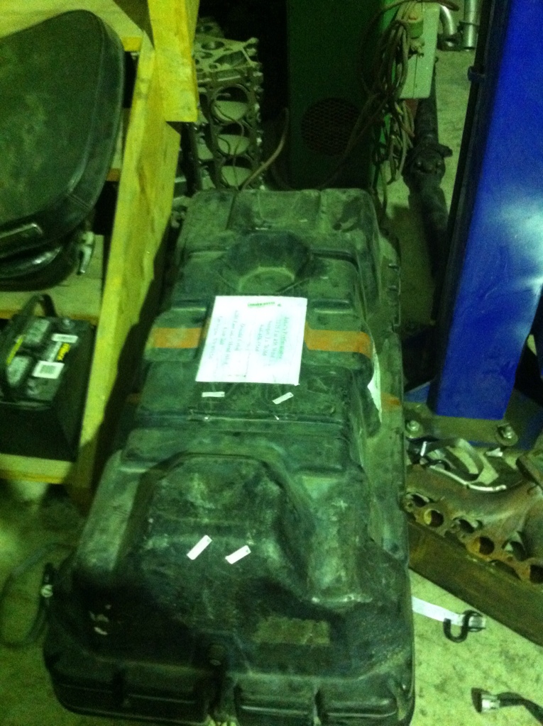

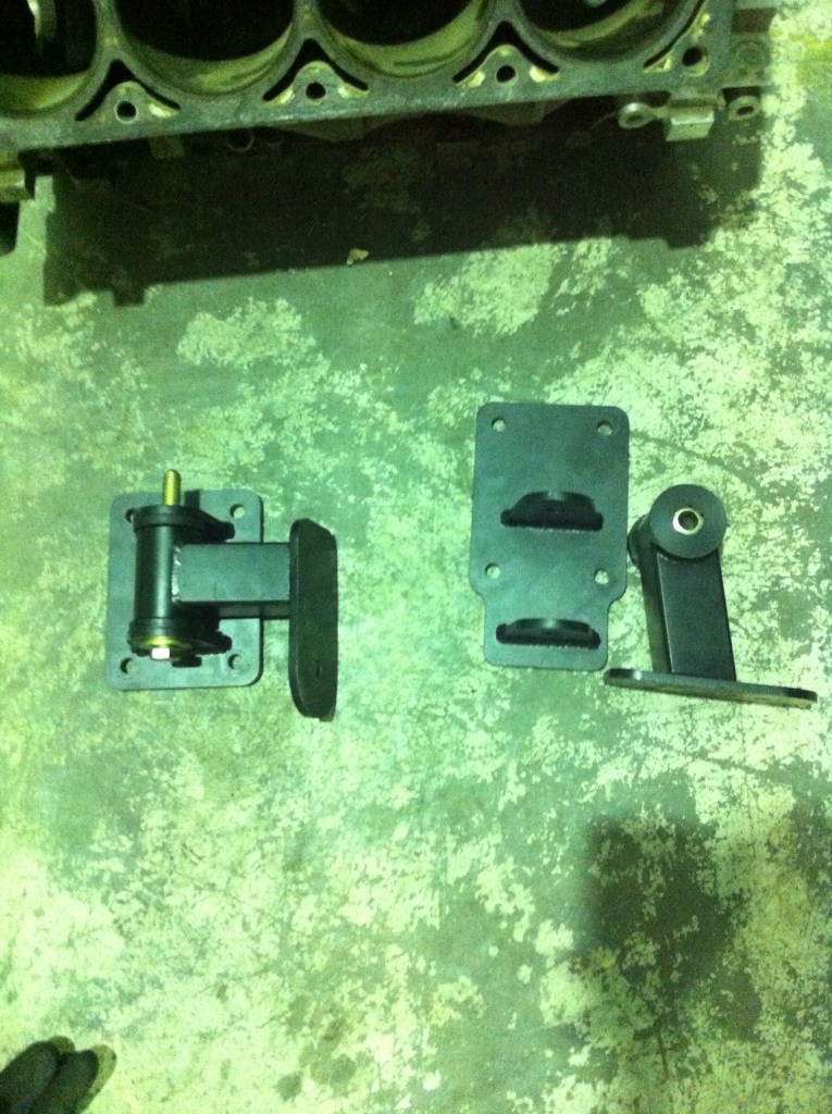

Jake brought me something as well...
