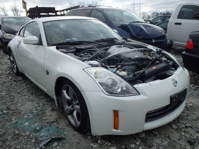

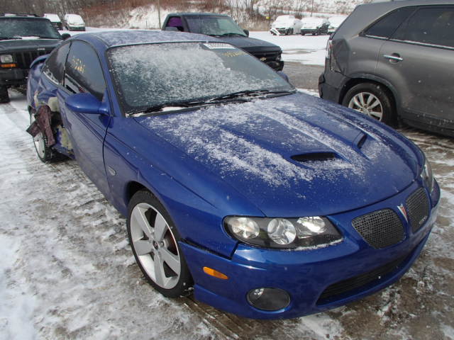

Ok, I have been reading for sooooo long and have been inspired. Picking up the Z Monday and GTO Wed. 2000 miles of driving but I MUST join this club!!
Attached Thumbnails The Official LS Swap Info/Questions Thread-06-350z-ls2-project.jpg   The Official LS Swap Info/Questions Thread-06-gto-ls2-350z-project.jpg
