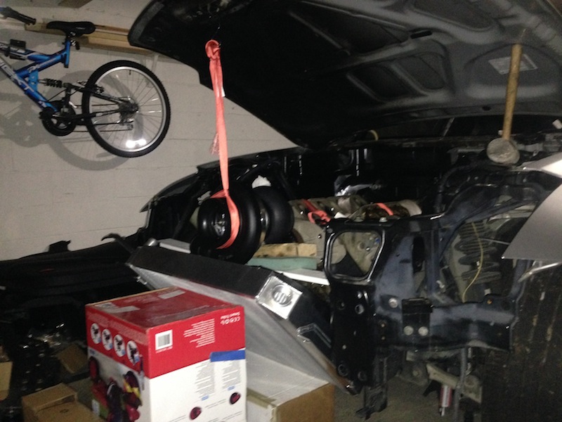

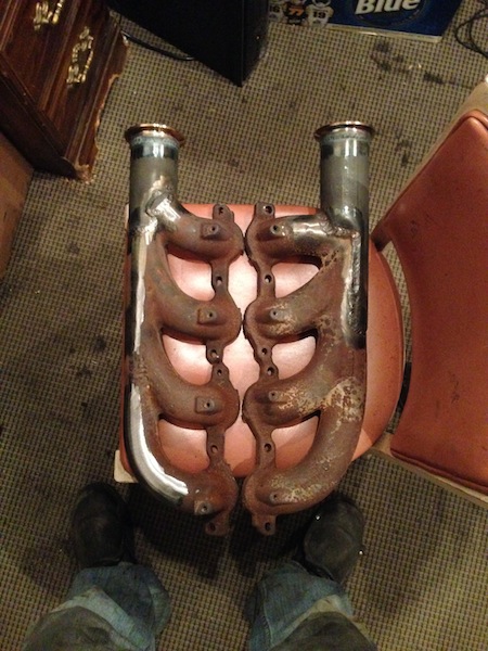

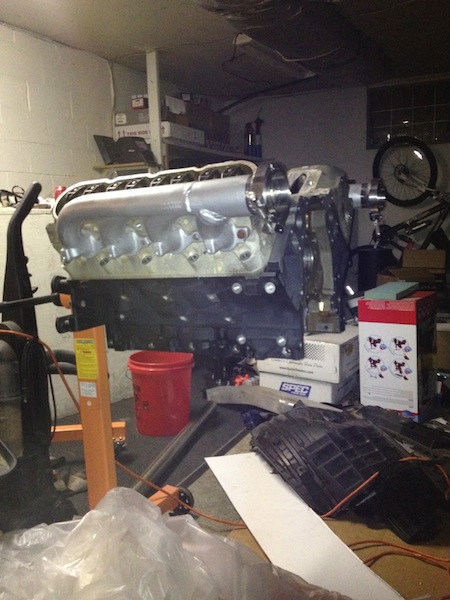

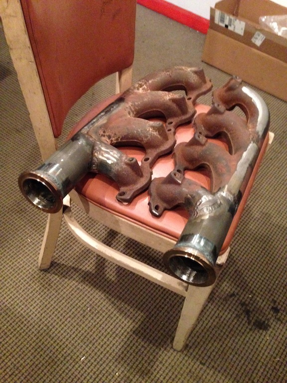

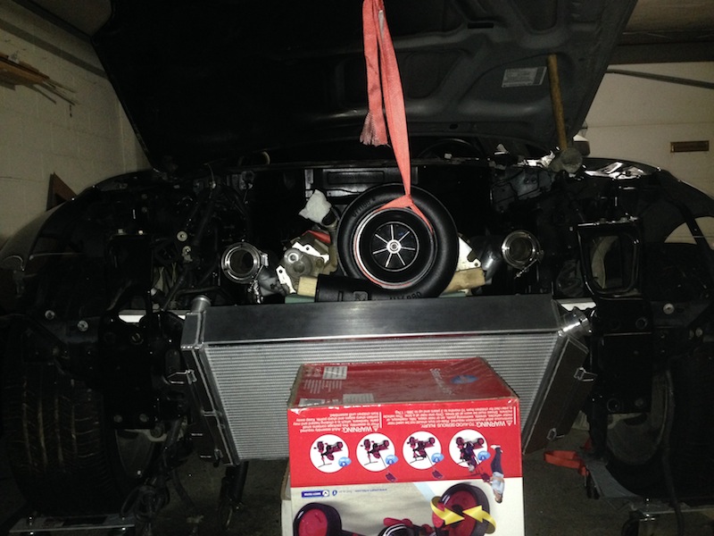

Here is how the manifolds turned out, they are still a little rough, i sprayed some paint on them while they lay around the garage for now. When all my hot side goes in the car for good im going to sand it down a bit , hi temp coat them and wrap everything.
i quickly slapped everything together so that i could mock up all the plumbing, you can spot the motor , quicktime bell housing and my most prized possession , brand new TR6060 with Ticks performance level 5 build good for over 1000RWTQ
and the sleeper outlaw style turbo mount.
Attached Thumbnails The Official LS Swap Info/Questions Thread-img_1909.jpg   The Official LS Swap Info/Questions Thread-img_1908.jpg   The Official LS Swap Info/Questions Thread-img_1769.jpg   The Official LS Swap Info/Questions Thread-img_0261.jpg   The Official LS Swap Info/Questions Thread-img_0259.jpg
The Official LS Swap Info/Questions Thread-img_0110.jpg

Looks great!!! I went 4L80e That turbo...OMG.
You happen to have a pic of the GMPP CTS-V accessory drive mounted? I actually pieced the Holley accessory mount kit with the ctsv drive components but scratched it.After two weeks of measuring I'm still on the fence for manifold placement. This will depend on drive accessory setup apparently.

A friend of mine has a 6.0 with that accessory drive bolted on in an engine stand in his garage. So i have test fitted my headers on that. If you google you can find pics of all the setups, vette, trucks, f-body and ctsv (essentially the same as a f-body layout) with their exact measurements.
the vette is too wide and hits the strut tower, trucks is narrow but too high and it hits the hood ( i have it ) f-body and ctsv is the way to go. I think you are better off planning your headers around the system and not the other way around.
in my case i still have room to keep AC compressor and route a 4 inch downpipe sandwiched between the top water neck and the manifold, but im simplifying and taking the weight savings and dumping it out front. An old timer once told me the best exhaust is no exhaust lol.
