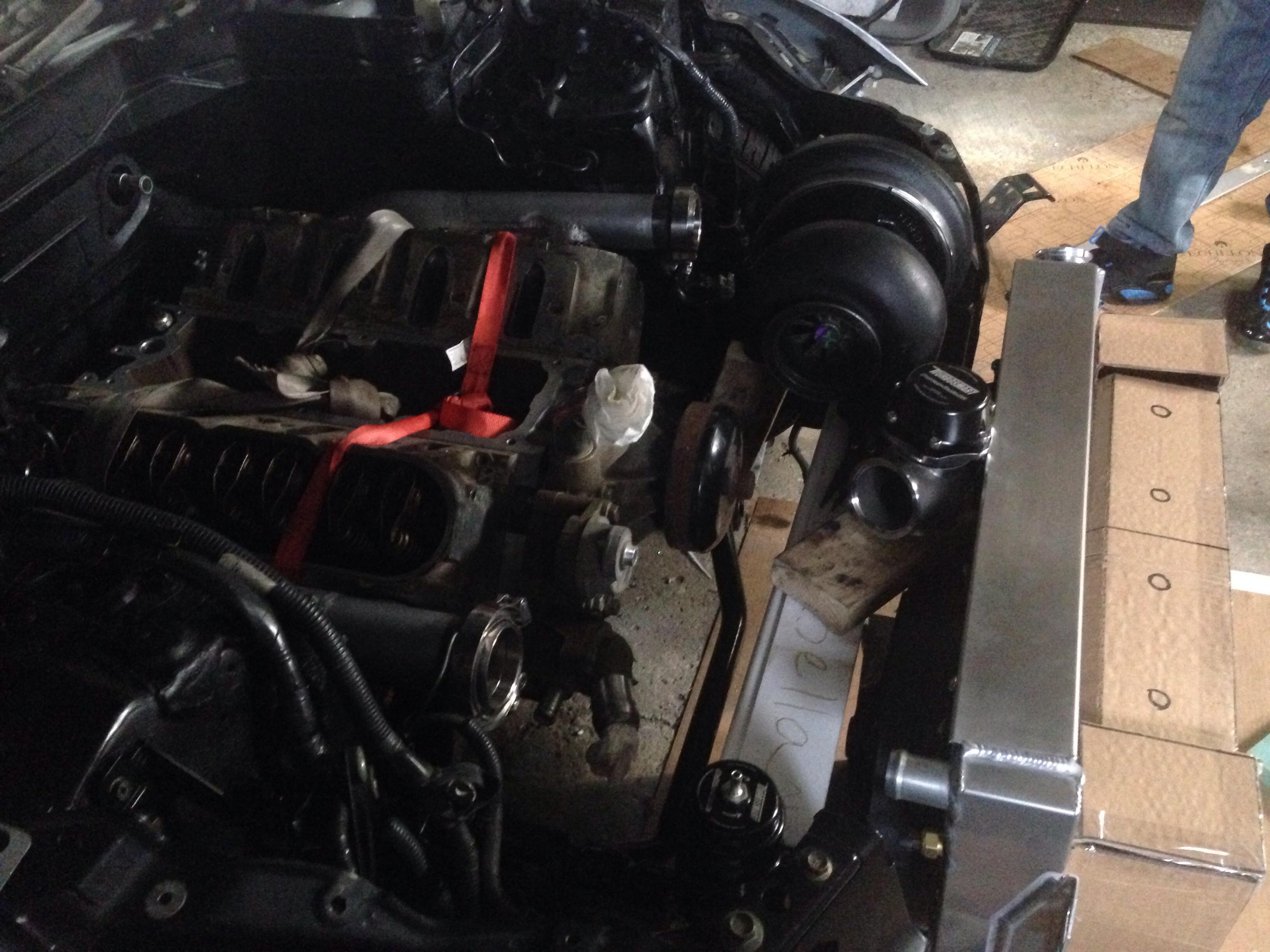

my car is far from running but i have the motor and tranny bolted in for measurements, and i love the engine placement, as far back as we could have it and tons of room up front. There is enough room for a pretty big borg warner unit. I bought everything they offer besides the headers since im going forced induction.

Bad quality cell phone pic taken late at night in the garage, but you can get an idea.
Attached Thumbnails The Official LS Swap Info/Questions Thread-image.jpg

Ive joined here to read some of what you guys have done in your setups. As i read back through the pages i notice alot of guys have questions regarding the fueled kit. Maybe a unbiased opinion will help some.
I bought my kit over a year ago, dont even remember who i dealt with. Everything seems of excellent quality, the motor sits as far back as it can go, i had to do ZERO cutting. Matter of fact there are only two spots i will have to address, one is in the bellhousing, it does not touch the firewall but there is one spot that sits about 1/8 to 1/4 inch and i will slightly hammer it in when the motor comes out, just for safety. The other is on the top passenger side, there is a little bulge on the firewall, where the battery is located more or less, that hits the screw on top of my valve covers. Its one super long screw that holds the coils on top of the cover. I will just trim it, also not a biggie.
Over all im very satisfied with it. Ill be happy to address things for guys that are on the fence.
