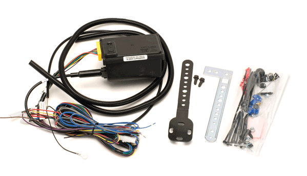

im not on drive by wire im running the a throttle cable with with 102mm FAST throttle body i used the dakota digital #CRS-3000 with the HND-2 dash mount switch no need for vacuum needed for this unit and i have it tucked away and built into my harness as well. The company i work for is a dakota digital dealer which is why im testing some of their products to help us guys out with keeping our luxury items like cruise. Should have a finalized system for a plug and play for the factory tach by first of next week.

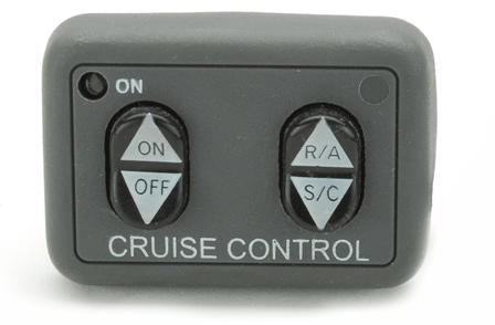

Its just a coulpe of wires that read off the VSS signals and the dakota digital unit uses a electric servo to control the throttle body here is a picture of the unit. It retails for 245.00 with your choice of handle and i used the dash mounted one that is located under the dash but going to order a second unit to tear apart to connect with the factory steering wheel buttons.

Originally Posted by str8dum1
how hard was the install of the cruise control module. thinking about going to a cable TB but cruise control is a must
There is no need for brackets you can buy a 240 pedal like i did and it bolts right in

I had plans of being at zdayz last year but i was waiting on my tune but expect me to be there this year with all the rest of the crazy alabama guys. She already knew how to drive a manual and this car is so easy to drive i taught my 18yr old cousin how to drive a manual with in 10 min without stalling out once.
Drove to work with cruise on 80 the whole way its a simple unit to install, and with no vacuum lines makes things simple and clean.
