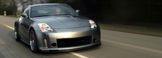

i jus love that body kit wit a big fat passion

It looks 100x better without that hole for the intake. It is ok. It would be good for the intercooler and looks like you could fabricate some good front brake ducts. The rear looks ok too but I still think the other kits would be way more effective.
