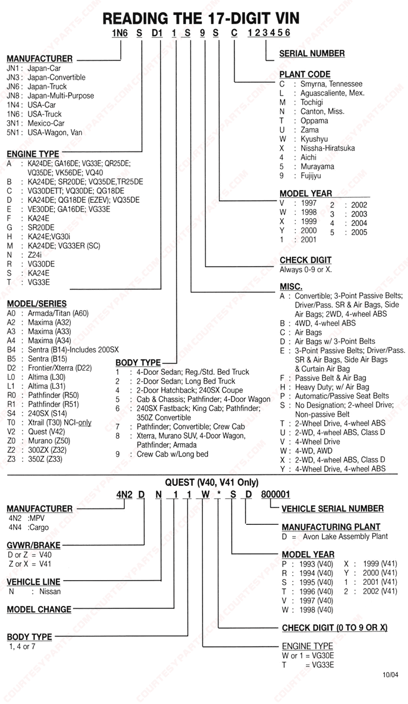

Check your VIN #'s against each other to see if they were manufactured at the same plant.
This is from 2004 but the plant codes should still be the same:
