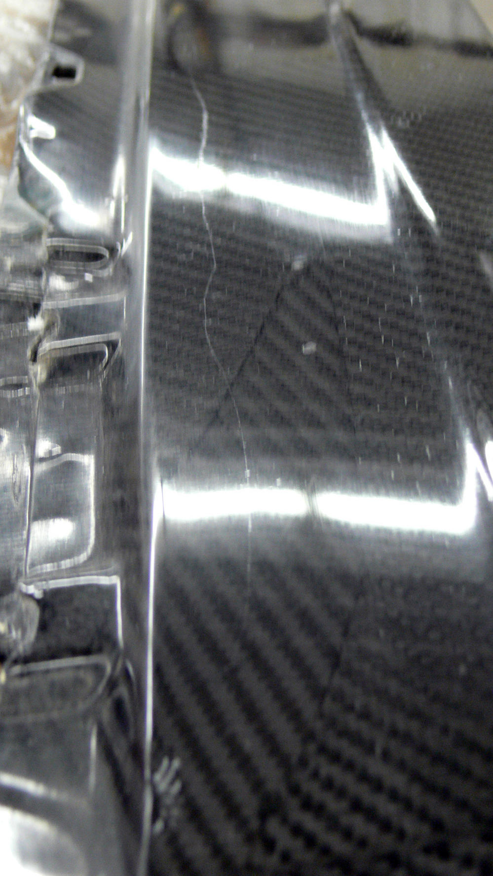

Please post better pics of cracks.... I cant see any..
Other than that I see all the other flaws as repairable..

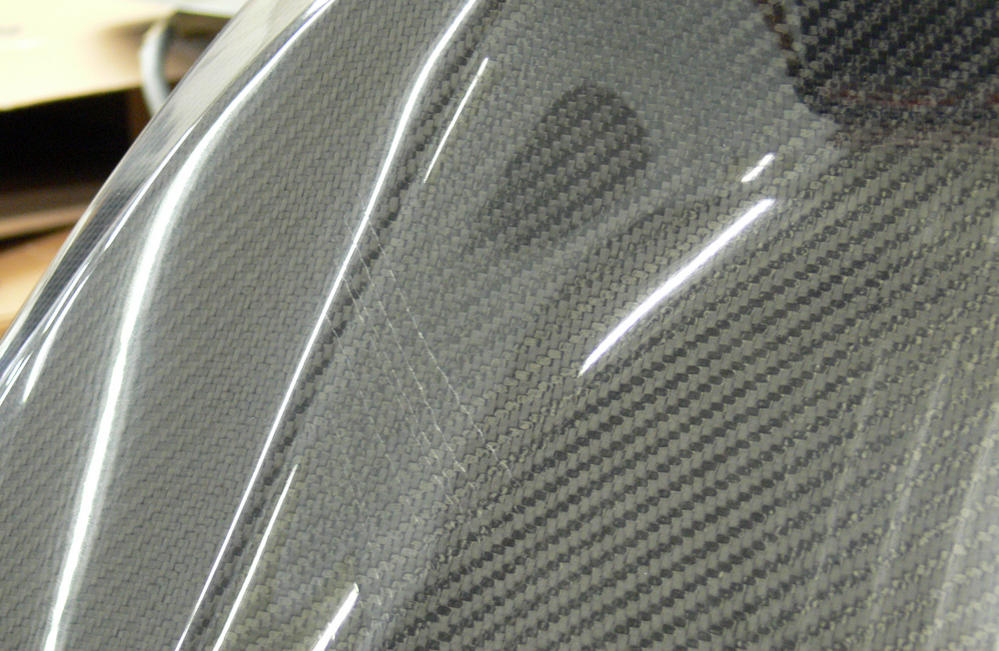

The 5 horizontal lines in this picture are cracks under the clear coat. Very hard to take a picture of to show it any differently:
https://my350z.com/forum/attachments...h-p1010896.jpg
Old Oct 19, 2009 | 11:13 AM
Jay'Z's Avatar
Jay'Z
iTrader: (118)
Posts: 10,944
From: Carbon Fiber, TX
Those look like scratches not cracks..
Any CF Scratch can be buffed out IMO.. I have buffed out huge scratches and sanded to cracks, then it has to be recleared.. Not a biggie IMO, since they prob didnt clear it very good anyways..
Isn't it odd that there would be 5, almost methodically spaced out lines under the clear? We're pretty positive that they are cracks below the clear, but without sanding down that far it's impossible to tell.

Like I said before, your pics arent helping at all.. Need more of these cracks..

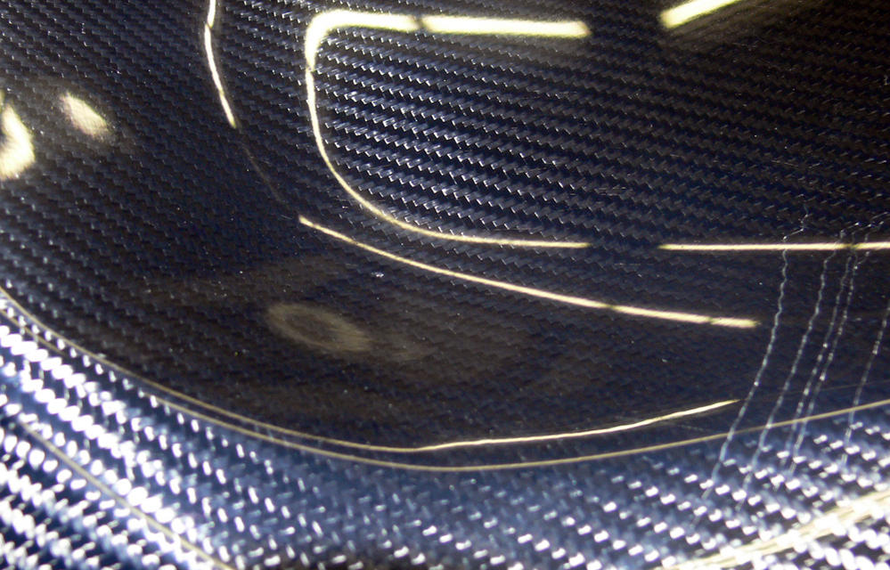

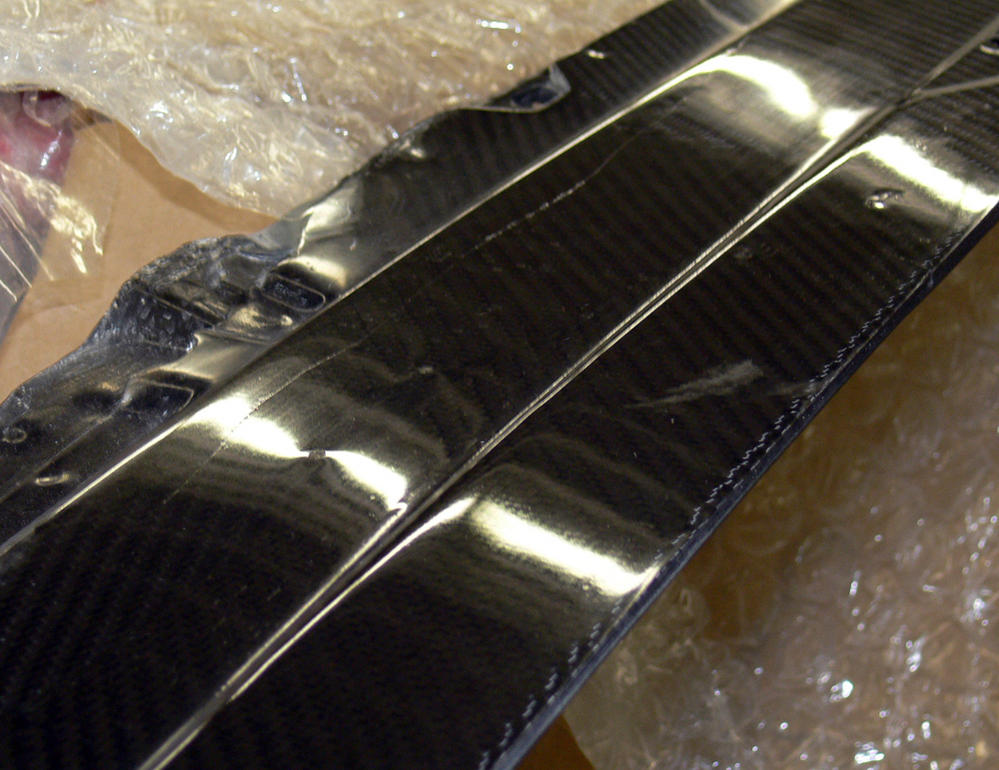

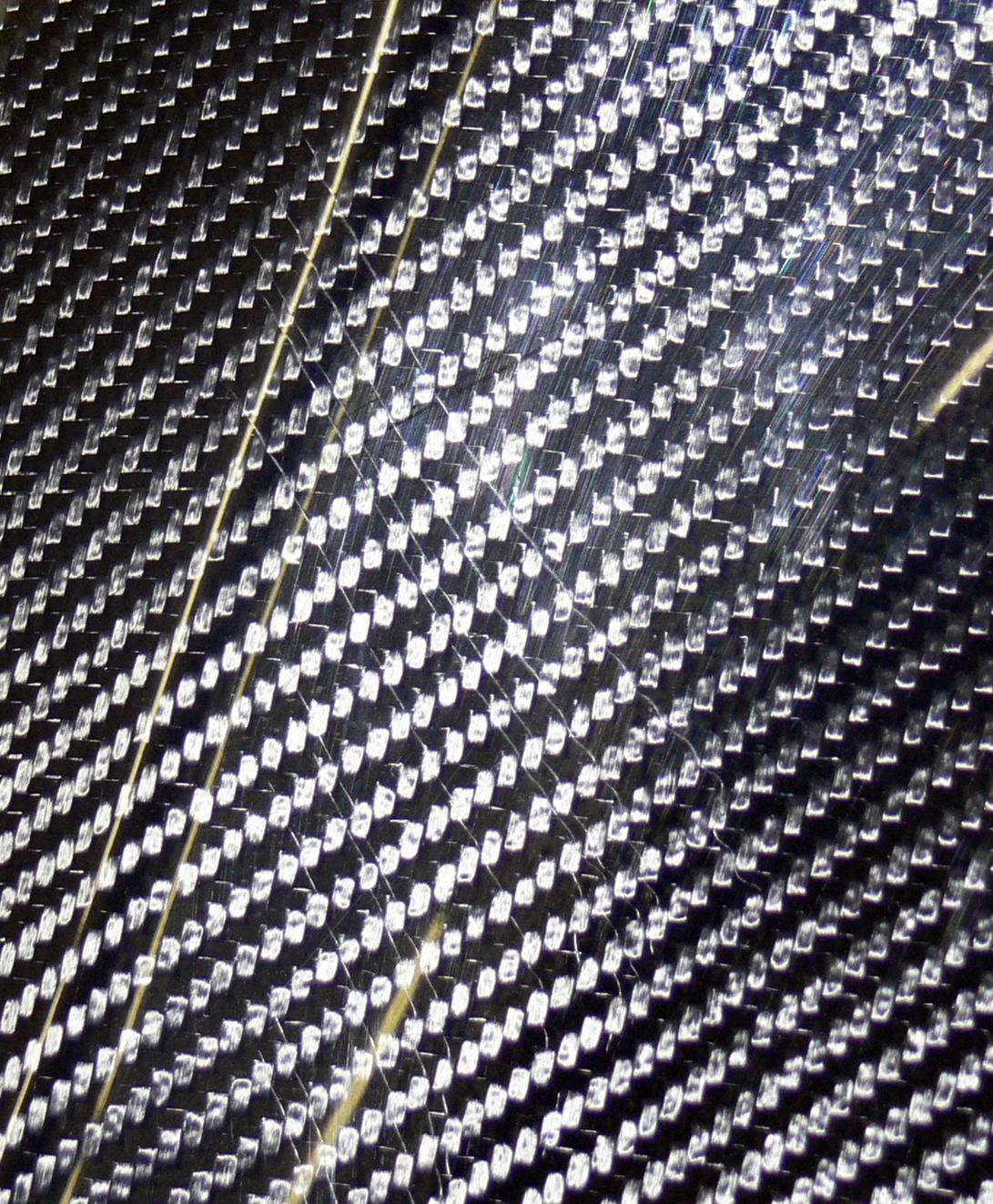

After getting another guy in the body shop to look at it with me he pointed out that the cracks that I thought were UNDER the clear coat were actually THROUGH the clear coat, meaning that the clear is cracked all the way down to the carbon fiber. It is not a scratch, and it is not under the clear.
So I got this message from Boomer of Mastergrade:
i seen the pictures, i can't really tell how it happened. We inspect our product very well before we ship it out, we also pack it very well so it won't get damaged. We would send you used or junk parts. The ball is in your park, if your not satisfied we can reship another hatch. Ship that one back and I will refund the cost. Call me if you need help setting it up.
This sounds great, but I have a lot of apprehension just sending it back because who can tell how long it will take, and if the new one will be any better.
Here's the problem: Sure, the biggest worst cracks in the lower corner may have been damaged in shipping, but none of the other scratches could have been done in shipping. They're little scratches. There was a TON of paper/bubble wrap on this thing that it had to have happened before shipping.
I just don't know what to think... I tried to get some more pictures of the cracking and I didn't have much luck with it, but here's some more, hopefully better shots.

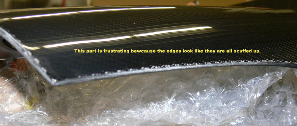

So Boomer says I just need to send it back and get a new one in the mail... Well how much is it going to cost ME to ship it back? A regular consumer, it will probably be $300 to ship it to California, not to mention the down time on top of the time it took to get this one...
I suggested that if he sends me a good one I'll use that box to send this one back.
Attached Thumbnails Issues with new Mastergrade CF Hatch-p1020257.jpg   Issues with new Mastergrade CF Hatch-p1020261.jpg   Issues with new Mastergrade CF Hatch-p1020263.jpg

As for your hatch, the resin cracks can be carefully repaired by any competent composite shop. However if you can get a replacement at no cost, other than time, go for it.
