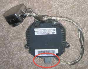

So my problem is that I have no way to plug into this ballast from the stock wiring harness. The ballast has a 9006 plug and I do not know what the factory plug is. So my options are...
1 - Buy a 9006 adapter and splice it into the factory wiring running to the factory ballast.
2 - Buy both a 9006 and a factory matching plug and create a conversion adapter so if necessary it can be easily reverted back to the factory ballast. This is my ideal option.
So does anyone know what type of plug this is??? (See pic - Taken from some random craigslist ad.)

Here is a 9006 adapter that DDM sells but would require splicing into the factory wiring OR buying the appropriate adapter to plug into the factory harness.
As seen in this next pic from DDM... I need to find a plug to take those wires and be able to plug them into the connector coming from the vehicle that would otherwise normally plug into the above picture.

Did you have halogen headlights before? Because you would probably have then had a 9006 connector that just plugged right into the new ballast...
I am unable to find any kit specifically for the 350Z's with HID's from the factory. I also spoke with a lady on the phone there and she pointed me towards that adapter...
