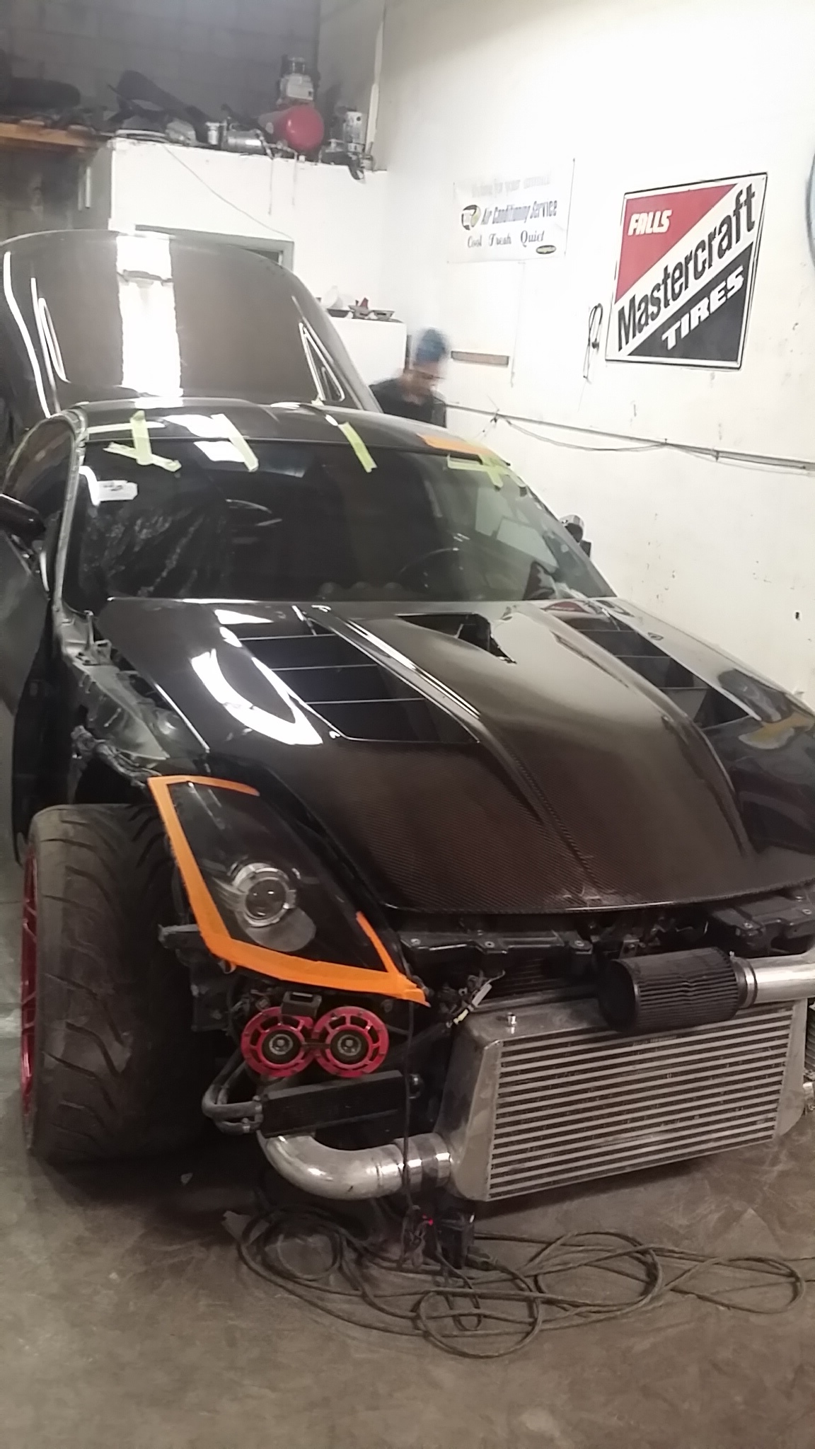

So the fender braces interfere w the wire tuck and the main harness, so were going to have to redo that.. so these are on hold for now.

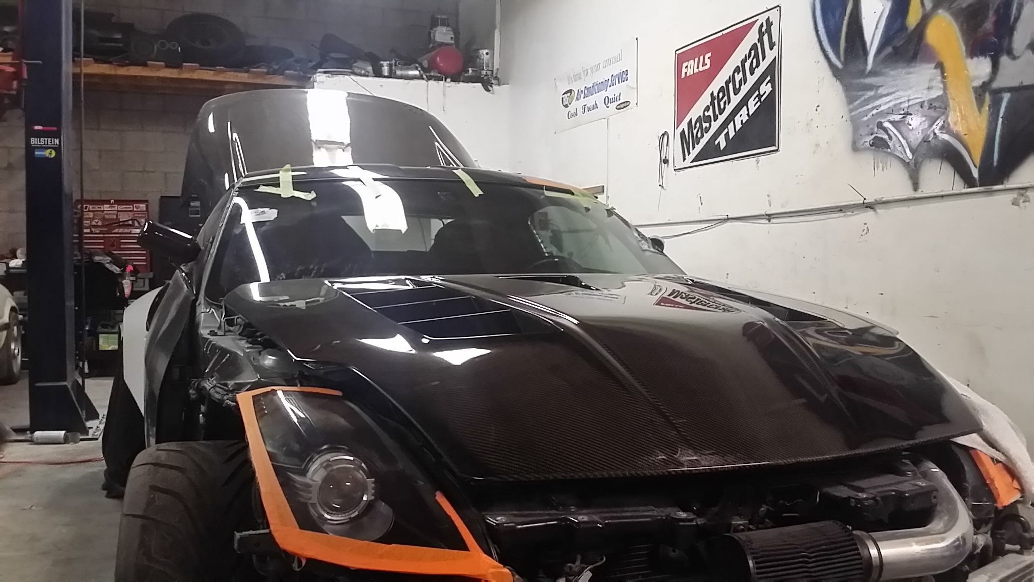

we still need to block and primer the JP bumper and finish the rear bumper.. ^^ ( you can see the front flare reshape here too)
but the roof piece and new windshield are in... same adhesive used for both... ie, windshield urethane... if it cracks or is destroyed and needs to be removed.. we can still cut it off if need be... but otherwise it is permanantely bonded to the roof as is.
everything is getting wrapped over.. im not going for tons of exposed carbon fiber here lol

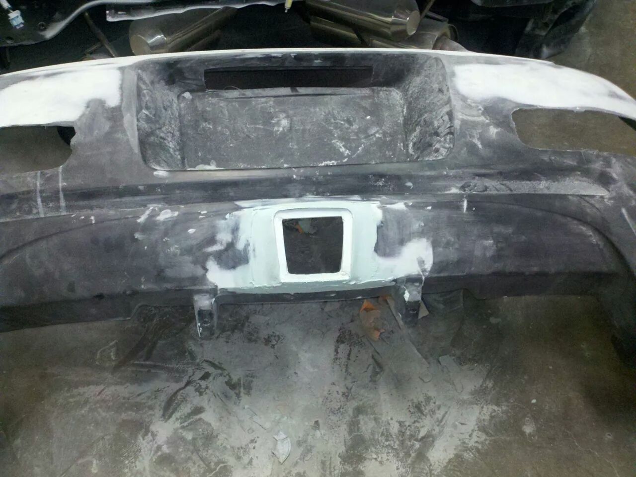

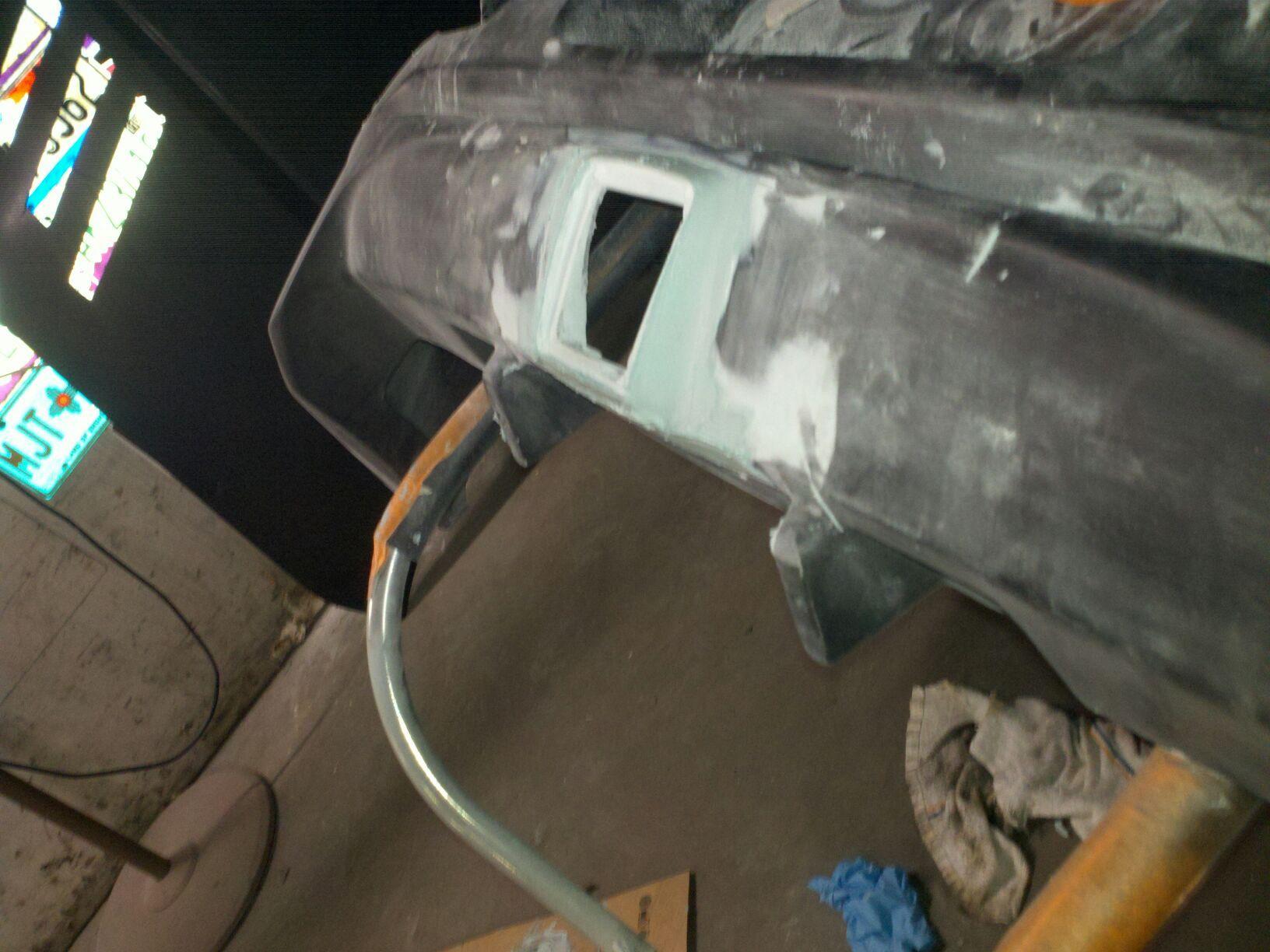

Rear bumper fog light area has been mostly completed...
the do luck diffuser mounts to those stanchions you see and hovers just below it.. we notched it a bit to allow the shape of the light to follow thru to that piece as well as keep the light unobstructed
the holes in the ridge across the top of that are were a bit messy, so we lined them up and made them bigger, but also then hadto go back and make the (now) super thin divions a bit thicker.. back to how they should have been.

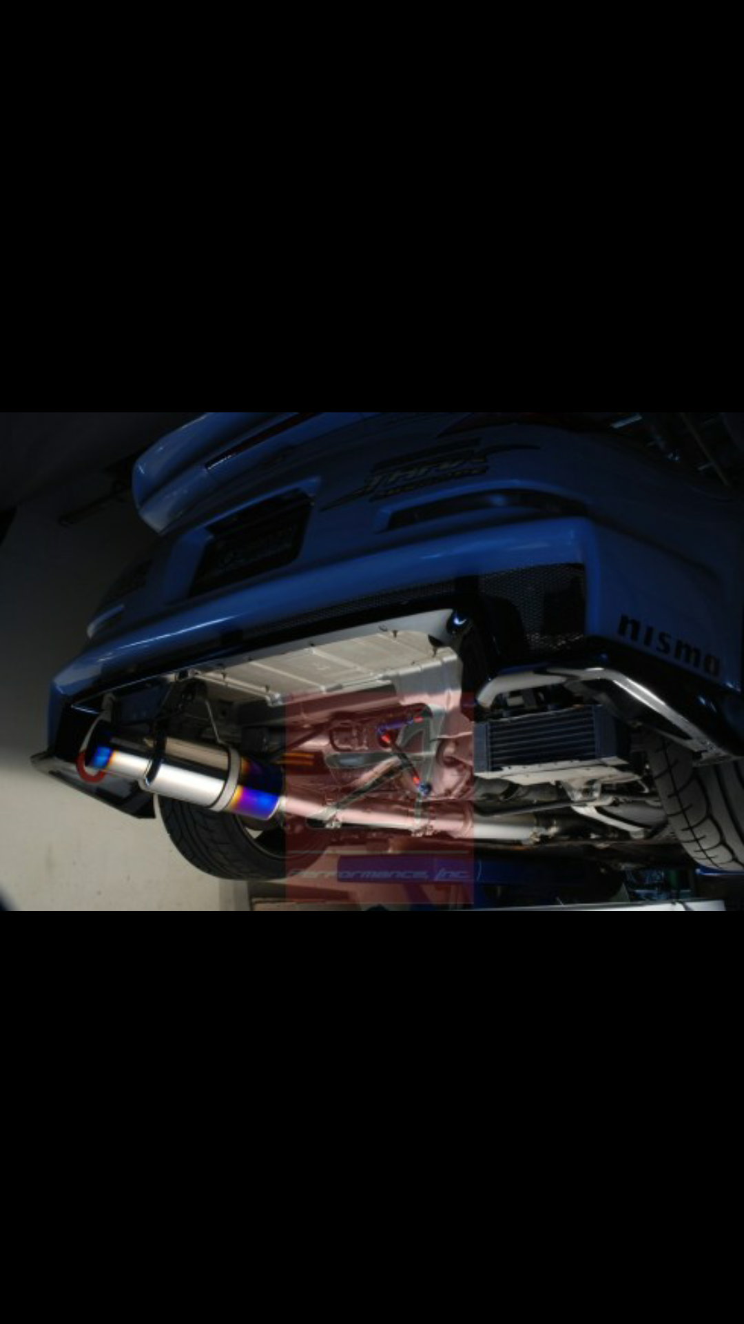

Bought myself a new exhaust too.. no more HKS rep w frankenstein stich up to a reverse y pipe..
Tomei Expreem full ti.. opening the wastegate to open dump... routing the electric cut out after the downpipe (before the cat) out to the drivers side side skirt.

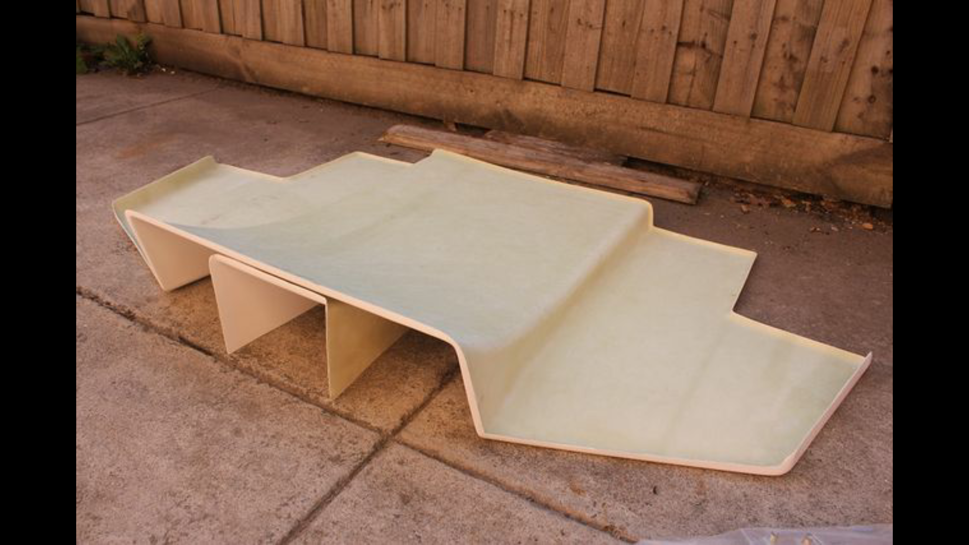

Also.. i had been wavering on retrofitting another brands diffuser under the car.. but couldnt find one suitably "functional" enough.. the TS GTR style is too short, too narrow, and the diffusewr section was barely wider than the license plate.. same with the RE Amemiya version for the FD..
What i did fin was a Garage Kagotani FD3RX7 diffuer that is a MONSTER...

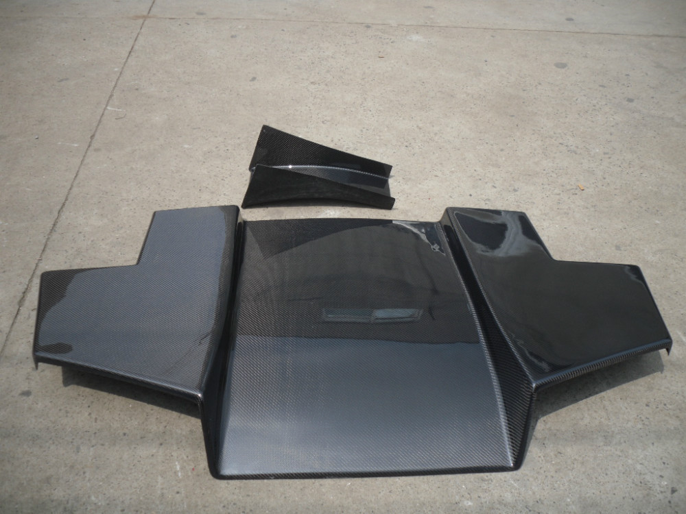

I opted for the carbon fiber version vs the frp one:
and come to find out.. someone in japan just used one of these as well lol...with modification of course, similar to what i planned to do already.
