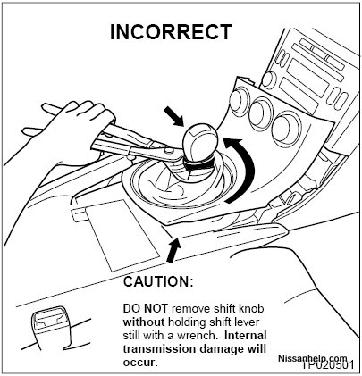

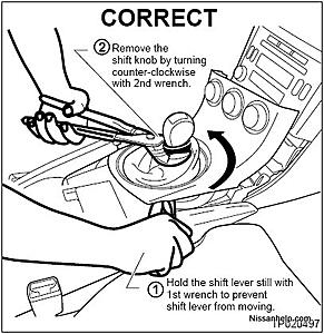

The shift **** usually comes thread locked from the factory. If it hasn't been taken off before, you'll have to break the adhesive before it starts to unscrew.
Pop off the shifter trim and hold the shifter rod straight with a wrench while you twist the **** counter clockwise (try twisting by hand first). It's a lot easier to get the **** to break loose and a lot safer on your parts. If not, the assembly will just twist and flex with the **** while you're turning. That's how you get a lot of guys on here sheering apart their stock ***** wondering why their **** wont come off. Don't be a bozo and try to hulk twist the **** without holding the shift rod straight.

When I replaced mine a few months ago I did as shown in the picture using a thick rag over the oem shift ****. Long story short after 5 mins of struggling I removed the rag n went hulk on it and destroyed it but I got it off.
