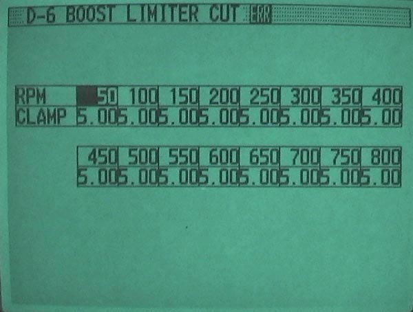

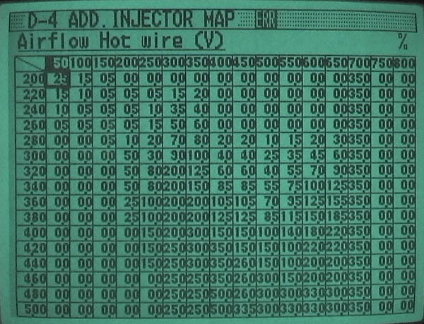

Well emailing a base map wont help unless he can load it with a laptop and you need the Greddy software and cable.
Here are the setting for the base map, no ignition since the stock doesn't have ignition in it.
You also have to set the basic parameters on the e01 like the injector sizing.
Attached Thumbnails emanage help-addinjectormap.jpg   emanage help-boostlimiter.jpg

thanks westpak for the effort to load those images. i believe i am running nearly the exact parts as sharif so i will get everything powered back up and run through everything on the e-01 to get familiar with it first then call if i need more help. the info i got from sharif on aim should get me able to start the car atleast which is mostly all i need, thanks.
