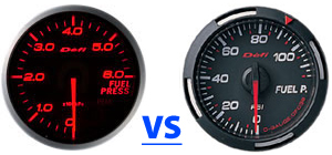

I am trying to decide between the D-series Defi and the BF series Defi gauges. One of my main concerns is simply being able to comprehend what the gauges are telling me. I am used to PSI readings, as my last car had a PSI Boost gauge and PSI Fuel Pressure gauge. I think I have come to grips with the BAR-PSI conversion, but I don't understand what I think is a "kPa" to PSI conversion?
Attached is a picture of the two gauges in question. On the right is the gauge that I am in intelligent enough to comprehend and on the left is the one that is boggling me.

basically, 100kPa == 1 bar == 14.7 psi.

Okay, so on that Fuel Pressure gauge, where exactly would 65psi sit? Around 4.55?
PSI x .07 = Readout on Fuel Pressure Gauge?
just about. my 14.7 was rounding - here's a site with more accurate conversion info:
http://www.akronbrass.com/pages/products/metric.htm
according to my math, 65 psi == 4.48175 bar
