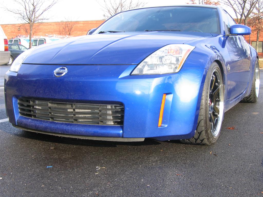

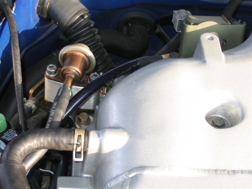

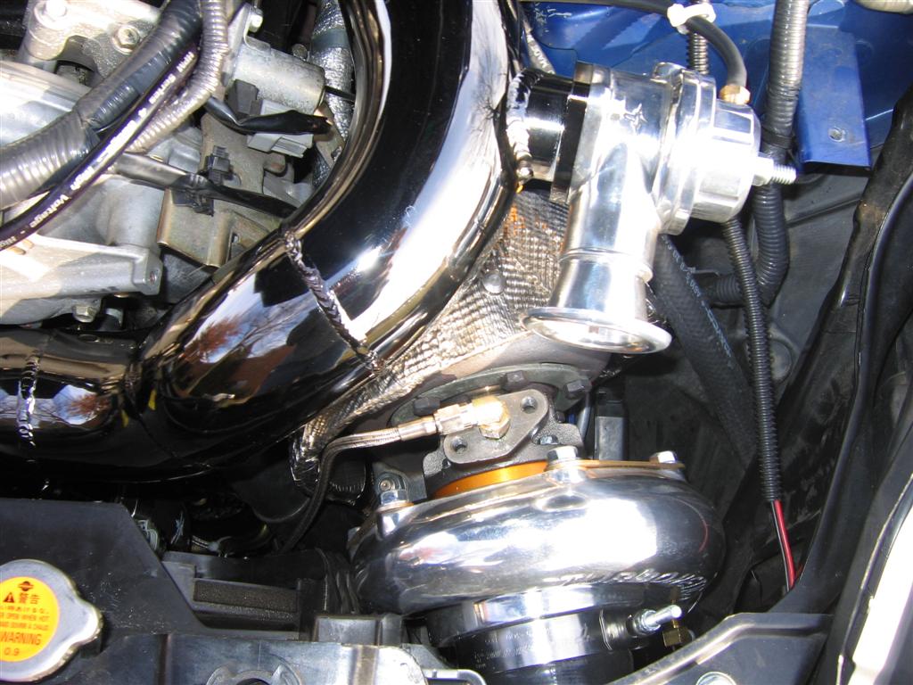

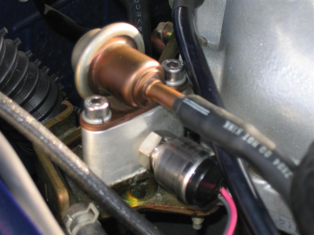

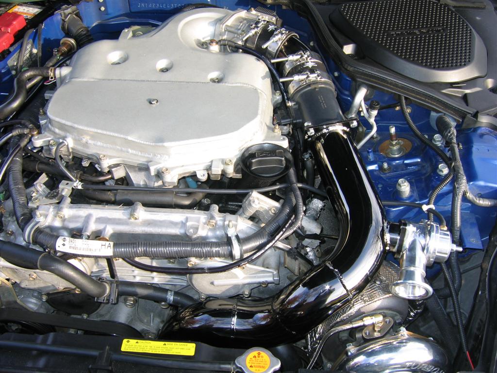

Thumbs up
Here are some pics of the SPT fuel line tap for the Defi FP guage, some engine bay shots, and a side shot of my car-excuse how dirty it is its been raining here....btw I will post pics of the exhaust and guages later, and if I can a small clip of the car.

Beautiful site man. How do those KDWs work out for the car? Considering those. Definately want to see some pics of the exhaust... looking at getting a single now.
